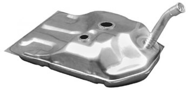

You have probably never owned a car that didn't behave this way. However you probably never noticed or cared. The only reason you notice it now is that you are constantly watching your MPG, miles driven, and you fuel gauge. This is something you probably never did on you previous car.
When I filled my old explorer, the fuel guage needle would peg on the stop pin well pas the "F", and would stay there for many miles before it started to drop. When I looked at the fuel gauge, I only cared about whether it was above 1/4 or below. If it was below 1/4, then I got gas, if it was above, then I didn't. I didn't track milage and I didn't have realtime MPG updates, so I wasn't sitting there saying "I know I've gotten XX mpg this tank and I've gone yyy miles, therefore I should be at 1/2 a tank, not 1/3".
You also have to consider that gas tanks are not perfectly square. Look at this one from an 87 Corolla:
Click the image to open in full size.
The only way to get a perfectly linear gas guage out of that is to use considerably more complex electronics than is warrented for something as mundane as a gas guage.
