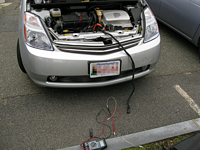

So why is there a wire hanging out the front of Neicy's car?
Click the image to open in full size.
She'd been having block heater trouble, and we dug in to debug what
was wrong. Turned out to be the same problem someone else reported
recently -- an open somewhere near the plug, possibly due to it
being pulled out and pushed back into the grille many times. The
heater element itself was fine, as was the orange connector going
into it [which was interesting to get a hand on using only the stock
Prius jack to unweight the front end and lying on cold asphalt].
Toyota seems to have selected a fairly inferior quality cordset to
build the wiring for these things from, but fortunately it's a
fairly easy fix.

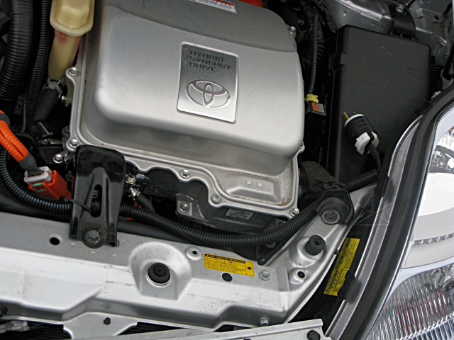

We pulled it back and re-ran it over toward the relay block,
chopped off the stock plug and put on a nice robust one from
the hardware store.
