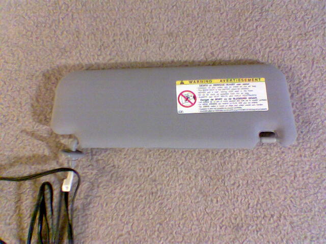

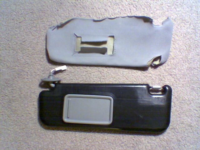

So, here are the pictures. Apologies for the low quality - other camera is MIA.
Starting with a removed visor:
Click the image to open in full size.

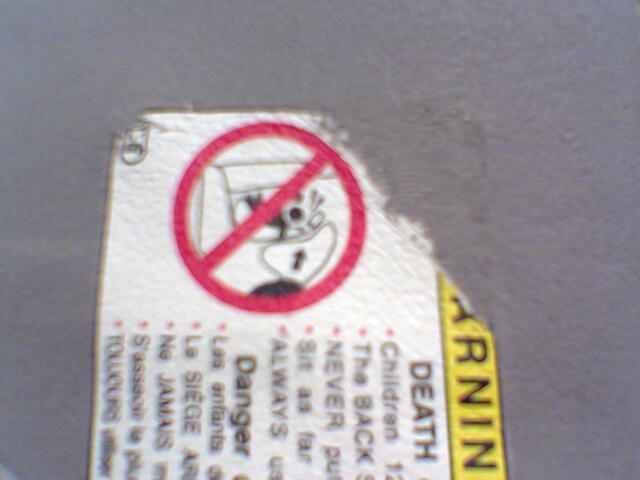

After an hour of fussing with the iron and a wet rag and then the steam wand from my Espresso machine:
Don't pull too hard:

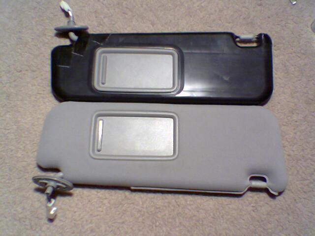

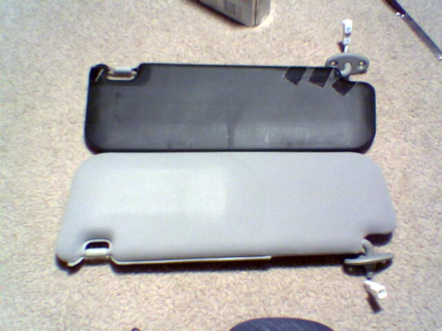

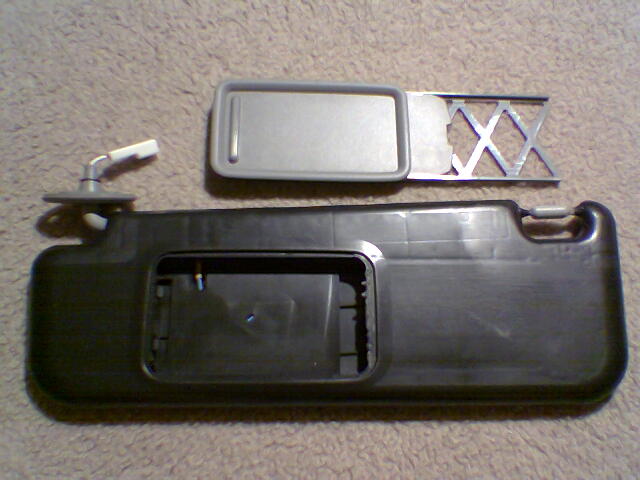

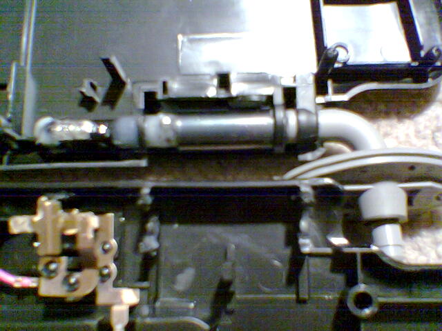

Since I've basically destroyed the visor, let's see how it was constructed:

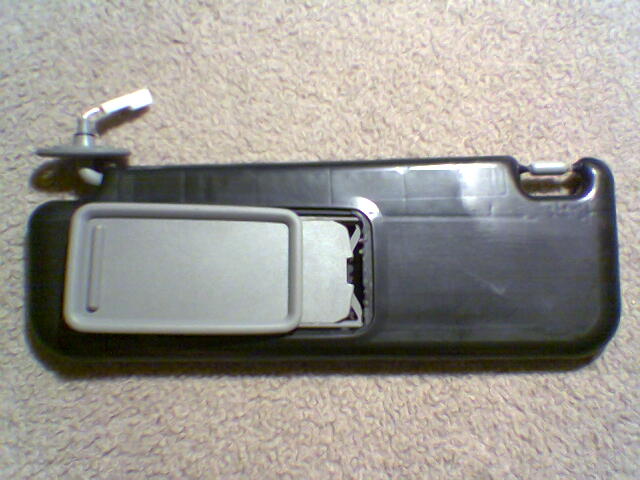

The mirror pops out. The glass cover has to be slid open and then there are two clips on the left of this picture. The mirror and the slide assembly remove as one after it's been removed from the clips and pulled up a bit.

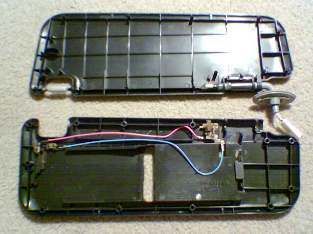

Don't try to take the plastic housing apart. The hinge is pressed in place and removing it requires breaking two plastic clips:

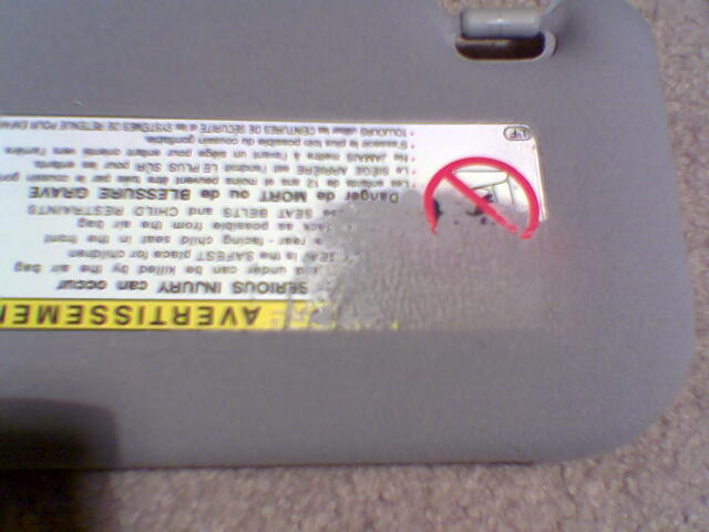

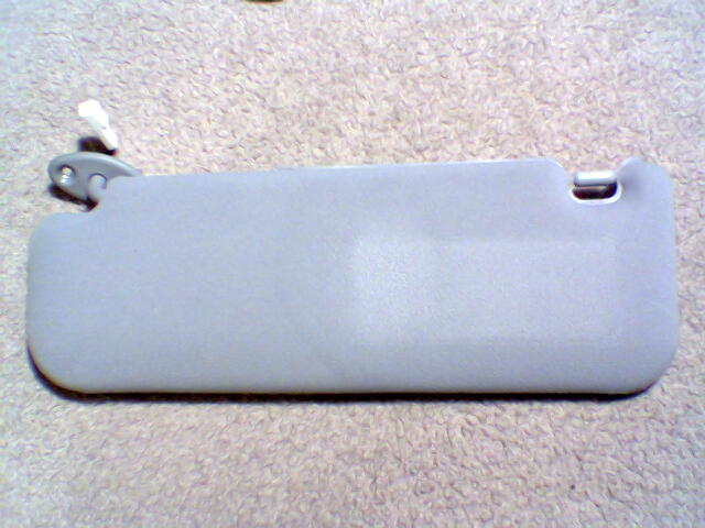

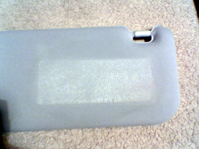

Well, I can absolutely verify that heat will do nothing to loosen the glue. After some research and two different sets of trial and error, it is my opinion that heat does nothing to remove the label.
I investigated other forums (BMW, Mustand, GTO, etc...) most folks say that heat does nothing and risks warping or melting certain plastics.
What I found is that the labels on the Prius are vinyl. The fabric and plastic are made of something else. Vinyl is dissolvable with Acetone.
I ended up using Acetone to wipe/melt the sticker away. The only other plastic items on the visor that reacted to acetone was the latch clip cylinder.
It's starting to dissolve...
And gone!
With more wipes and some brushing...
Here's the pair together:
I'm sure with time and some more scrubbing, the area with the glue residue will subside.
