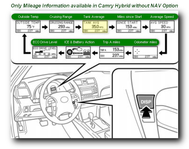

<div class='quotetop'>QUOTE(Tideland Prius @ Nov 14 2007, 09:49 PM) [snapback]539781[/snapback]</div>
Quote:
really? wow that is odd indeed. The other Toyota/Lexus cars with the Trip Computer have both AVG MPG and TANK MPG. Dunno why they left it out on the TCH.
[/b]
I agree... very odd! Here is what the Owner's manual shows for mileage or MPG info in the 08 TCH w/o NAV:
Click the image to open in full size.
Best Regards,
Wayne
