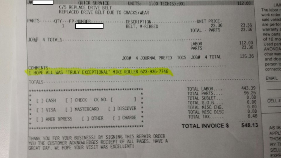

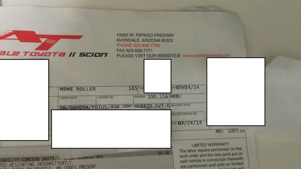

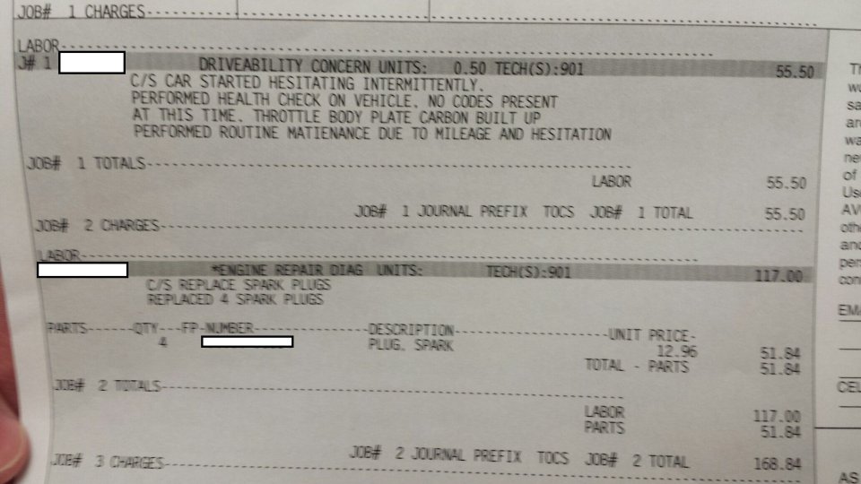

    I went to the Prius Dealership in Avondale, and I think they probably overcharged me. I got charged $548.13. The problem was, my engine hesitated several times, and it had only started that day. I thought it was going to be so bad, that the car would stall on the freeway. I would be hitting the accelerator, and the engine would hesitate before moving forward. Then, it would go, and then practically stop again. It did this several times. After I turned it off and back on, it hesitated a little, but seemed to be better. However, I did not want to risk going onto the Highway, so I took it in to have it checked. (I also uploaded parts of the Toyota documents.)

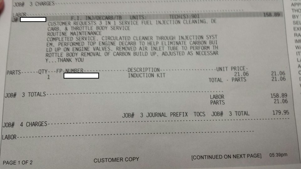

    They told me that the drive belts had cracks/wear, and I needed fuel injection cleaning, de carb, and throttle body service. They also changed the spark plugs. They said that these were routine maintenance items. However, I went to Big Two Toyota, and they said that everything was fine with the car (about 2 months ago).
    Was I price gouged by them? I might have gone somewhere else; however, I did not want to risk my car having issues on the freeway.
    Even though it was the drive belts, the extended warranty did not cover that component.

    You always seemed to get charged more when you are a bit desperate, and the dealers sensed it, went in for the kill.
    It's expensive but if the problem is fixed, then it's worth it at 100k miles

    Understandable...How much, in your opinion, should this have cost? What would be more reasonable?
    Also, why does an extended warranty not cover drive belts?

    There is no "Drive belt" only the serpentine belt (a wear out item so it is not covered by the Hybrid warranty, perhaps the 36 month drive train warranty covered it) whose only job is to spin the engine water pump, but if it was really cracked (a reasonable thing at 100k miles) replacement is a good idea even though it had nothing to do with your symptoms. The other items may help and I hope that one of them did.

    Yes, fortunately, I have not had problems since. And the car has actually seemed to run smoother than it has, so I suppose it is good, even though it was costly. No error codes came up though, ironically. It seemed to do the job though. The next thing I am wondering about is the hybrid battery. He said it usually lasts between 8 and 10 years for the hybrid battery to go out, which is interesting. I've also researched that too on Web sites and have found the same. I believe those cost $4,000 including labor.

    Every dealer charges different prices for service, I consider the services you did very minor and do those items myself. The diy price for what you did would be around $60.

    Was the car rained upon immediately prior to the driveability issues? If so, moisture may have gotten into the spark plug wells causing an engine misfire.
    Any warning lights on?
    Yes, you were overcharged for the services performed but that is normal behavior for a dealership service dept. especially since the car needed help immediately and you weren't in a position to call around for competitive quotes.
    The normal change interval is 120K miles for the iridium spark plugs. The throttle body does need cleaning periodically and a dirty throttle body can cause engine response issues. The serpentine belt needed to be changed but that would not cause the driveability issues.

    They probably gouged you a little but it was not $5,000. Your car is running good now. Don't look back.

    Yes, the car has logged 100,000 miles. Also, it did not rain recently before the car was doing this. Also, no warning lights came on, and the initial person who greeted me was surprised by that.

    you can look around for some hybrid shoppes while you have time and it is running well. i think the work you had done was worth $350.-400. at a dealer, so that wasn't bad. if you're not a diy'er, unless you want to learn, you're probably better off looking for a triple A mechanic, you don't need hybrid expertise to do most of the maintenance on these cars.

    The dealer charges $125 an hour so everything will be expensive. Y0u seem willing to learn and can take pictures. Lets start with you taking pictures of the throttle body.
    If the car has never had the throttle body cleaned in 8 years the carbon buildup sometimes turns into rust that can't be cleaned.
    Many tb's have failed because of this rust. The throttle butterfly is motor driven (fly by wire) and does not use mechanical linkage to open and close it and sometimes this rust makes it to hard on the little TB motor to operate properly and will fail. The engine will stall and it will throw a dash dtc. Its a very expensive part to replace if it fails around $2000.
    So.....take the air clean top cover off and pull off the air cleaner and take a picture of the throttle body bore and lets see how good a job they did
    for $200.
