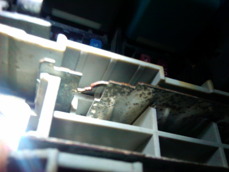

    did somebody replace the 100 A DC/DC fuse in Unit A in the Fuse Box of a Prius2?
    Yes, I placed the 12V battery polarity reversed, and I see clearly from above that it's blown. Now, it seems to be easily removed upwards, but it's sticked and I don't want to force it. I've read horrible stories about the prices of this replacement as it is too difficult to do at home. Did anybody manage to replace it, or is it absolutely unavoidable to take it to the toyota service?

    Another PC member had posted about how to remove and replace the fusible link assembly. I believe it is necessary to first remove the main relay/fuse box assembly in order to unbolt the fusible link from the bottom.

    Thanks. So no way to remove this plate from above:

    When you consider how much current is handled by the fusible link, it is not likely that spring-loaded contacts would be adequate to handle the current flow. Hence the need to remove and unbolt the fusible link...
