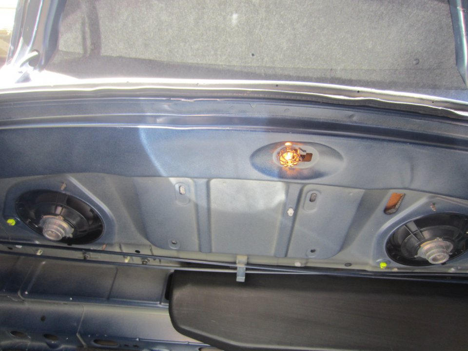

    What is the "luggage courtesy light"? and where is it located?

    The luggage courtesy light is mounted in the trunk, on the body of the car. It's often called "The Trunk Light".... and lets you see the contents of the trunk at night.
    It comes on when you open the trunk and is turned off when you close the trunk. Here's a picture of it looking up from about where the trunk latch is on the body of the car.
