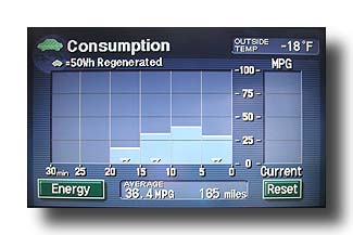

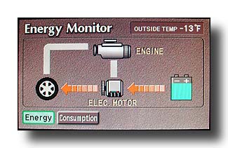

    Been there, but didn't do it...
    3 winters in Minnesota with my Classic Prius were fine. I'm one that never cared for hot from the heater.
    4 winters in Minnesota with my Iconic Prius were that way too.
    Then last year, finally having a scantool available, I gave grille-blocking a shot. The climate here is too cold to show much of a MPG improvement. Efficiency pretty much bottoms out. But can squeeze out more heat that way.
    Details of what I did are in the User-Guide.
