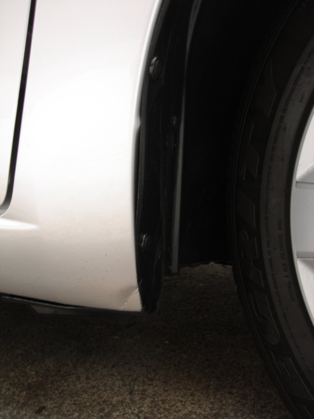

    Man I am piss, the tow guy that attach those stuff that hold the front wheel didnt attach them properly and look what happen :angry:
    How much do you think this will cost to fix? Or can I do it myself somehow?

    The tow guy damaged your car, the tow guy (or his company) gets to fix your car. Call the tow company and tell them they damaged your car. Why was it towed in the first place?

    I would see what your insurance company might be able to do to help. The tow company may not have the legal right to require you notifiy them at the time you pick up the car. What if it is night an raining. You cannot be expected to go over evey inch of the car at that time. They need to protect themselves from people who would report damage they did themselves, or after the tow, but it may be obvious that this particular damage is a result of towing. I would ask to see the actual truck that towed your car and make some measurements, look for paint transfer.

    I hate to say it, but if it's been that long since you were towed, I'd think you're probably on your own.
    Repair-wise, I'm not an expert but I'd guess that perhaps someone could bondo the area and spot-paint it...might not be perfect but it'd be lots better. And since it's so low, your eye wouldn't be drawn to it in the first place.
    It's interesting how the damage appears to have also displaced the plastic splash panel behind it...at least your car won't normally see salted roads, but make sure that road gunk doesn't accumulate behind the fender over time, if you choose to not fix the damage.

    I know I have said make the tow company pay, and take them to court, but if you are better with tools and like working on your car more than fighting with dead beat tow companies, you actually can fix it yourself with great results, fairly easily. The key is to buy good paint, not "Duplicolor", or other cheep / bad paint.
    Paint World Inc. sell very good color matched spay can paints, clear coats and paint blender spay at www.paintworldinc.com.
    A tale of two bumpers - I have painted two complete bumper covers, one with Duplicolor, and one with Point World spray paint, becuase the duplicolor was not available. The difference is night and day. Duplicolor bumper cover looks like crud, and the Paint World Inc. bumper cover looks just like the factory paint. I am not lying.
    Here are the steps and a marked up photo.
    1. Push the dent out from the back and pull the bottom of the fender back down as best as you can. Body filler should only be applied about 1/8 thick maximum.
    2. Use wax and grease remover before any sanding, or you will grind wax into your work area and this can cause problems with the painting later.
    3. Rough up the paint in the dent and slightly beyond with approx 50 grit sand paper. Then clean again with Paint Reducer (Fancy name for Auto Paint Thinner).
    4. Fill the dent with body filler and sand it to shape and smooth with progressively finer sand paper. Start with 50 grit and then move toward 120 grit. Re-apply small amounts of body filler in any obvious low spots and repeat as needed. Featheredge any damaged paint edges (so that it tapers from full thickness to very thin, to bare medal, if needed).
    5. Use Gray or Dard Red Surfacing Primer depening on your finish color. Which ever is closer to the color like gray for you since your car apears to be silver. Spay a light coat and let it tack up, followed by two or three wet coats that are allowed to tack up in between. The primer area will be slightly larger than the repaired area, perhaps up to the gray line I added to the picture. This primer is designed to fill small scratches and build up the surface.
    6. Let it dry for about an hour and then spay a very light overspay coat of the other color primer, dark red, over a larger area, overlaping onto the car paint beyond the repair, up to the dark red line. This is an indicator coat that will let you see any low spots when you sand it off. Let this dry for two or three hours.
    7. Wet Sand the primered area with 360 grit wet sand paper (the black closed coat kind) on a rubber sanding block. Wet sanding is when you wet the surface and keep a small stream of water running over the surface and your sanding block the whole time.
    8. When most of the red color is gone (like I show on the picture by the wheel well, you have sanded enough. There will be some low spots and pin holes in your repair and maybe some chips in the undented paint area that will show up as red dots. Also, if you sand down to any bare metal or body filler, stop, primer again, and fill any low spots with more body filler. For the tiny pin holes, spot putty can be used.
    9. Repeat 5-8 until you can sand down to a Gray Primer without any red pin holes, bare metal or body filler.
    10. Use rubbing compount without wax in it to thoroughly compound a larger area around the repair up to the pruple lines in the picture. This will help the new paint stick on the area where you will be blending it into the new paint. Try to plan areas where the body panel is narrower for blending if posible, or if there is a seam, you can mask to the seam and forget about blending in that area.
    11. Clean with Reducer and wipe it dry.
    12. Mask of the door and wheel well. You will probably want to mask of some of the door jam too, up to an inconspicous area inside like a ridge in the door jam.
    13. On a nice temperate day (around 65 - 70 F, in the shade, and no breeze, spay a light tack coet of color paint covering the repair, and up to the yellow lines (an narrow area like this makes the blending easier. When it tacks up, spay two wet coats, leting it tack up in between. If there is a clear coat, spay two wet coats of clear.
    14. One the color and clear coat tacks up well, spay the blender spay over the edge of the new paint and overspay in the old paint up to the green lines. This will blend the new paint into the old.
    OK, maybe Small Claims Court is less work. It depends what you like to do with your time.

    You rock, thanks a lot for the advice, when I look at the damage, it looked not that hard to repair, so I am giving it a try..

    Do you think grabbing the bottom part of the panel and hammering the bend panel that is popping out with a plastic mallet, a good idea?

    Sorry, I have been asleep at the wheel.
    I think you will want to remove the inner plastic liner in the fender well.
    At the bottom where you say pulling down here, if there is a flange or lip on the bottom, you could attach a clamp of pair of vice grip pliars with wide jaws to the flange and hold it at the right angle while you tap down on it. The wider the area you can grip with the clamp or vice grip pliars, the less you will risk distorting the flange.
    For the dimple higher up on the fender, hopefully it will get smaller as you pull down below. You can start by using firm pressure with you fingers to remove the dimple and pushing in on the back of the crease near the bottom..
    If you need more force, you might be able to get a small adjustable wrench closed tightly on the flange at the dimple to bring it back into place.
    If you need to use a mallet or hammer, you will want to have a hand dolly (metal bar about the size of a large bar of soap) to hold behind the fender flange while you tap on the outside or in fromt of the crease on the bottom as you tap from the back side.
    Start out tapping first, and use more force only if you need to. You can try a rubber mallet, but you may find that it just bounces around without really doing much. Give it a try though, and use a flat metal hammer if you need to.
