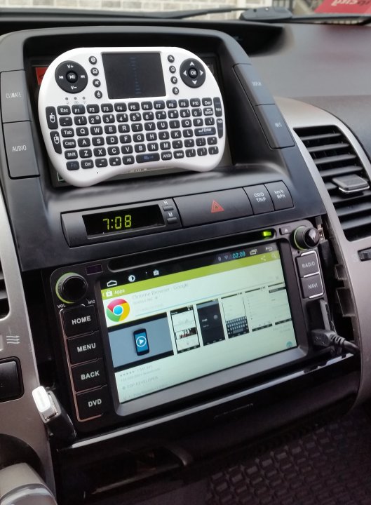

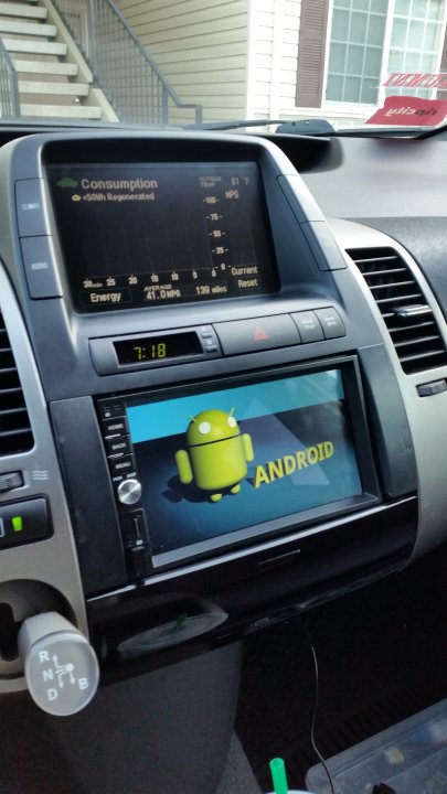

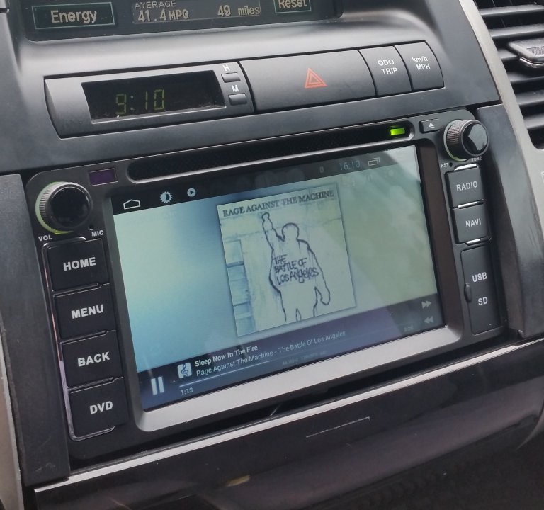

    I just finished installing a 7 inch Android powered double din head-unit. I've had it running for about a week now. I'm making this post in case anyone else has the urge to install a similar set up in their Prius. These Android head unit are popping up all over on eBay so you may have some questions about it before taking the plunge. Pics of it installed below, I did my best to get the colors to match the stock colors. You can pretty much change the button colors to whatever color you want.

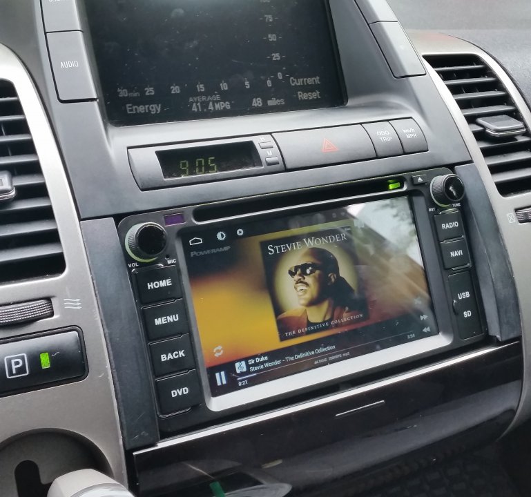

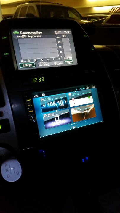

    Alright, the new unit has arrived and it has been installed. I will not mess with the firmware this time. Hopefully it wont stop working like the first 2 unit that I received. I updated the firmware and probably caused the bricking... I'm kind of happy those stopped working because this one fits nearly perfectly. I had to cut the flip open tray a little and the side bezel pieces had to be cut a little more.

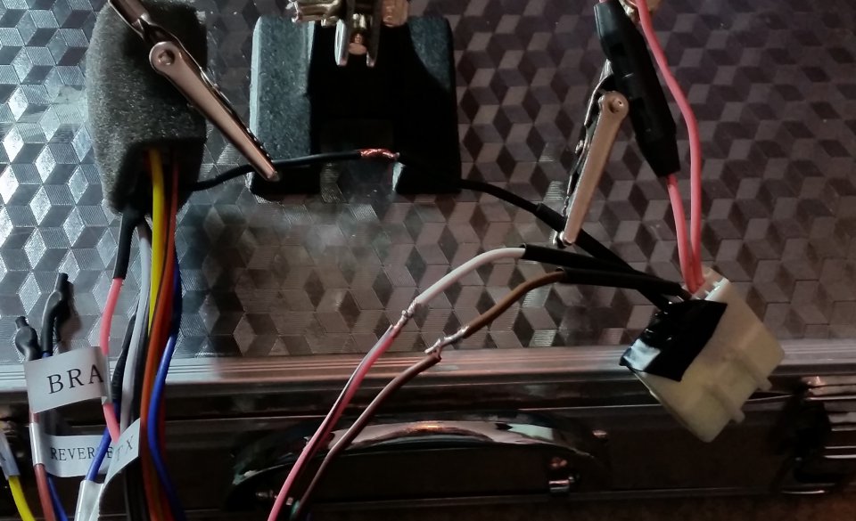

    The unit was designed for a Toyota Corolla, so the harness is almost exactly the same. The only thing you have to do is add the resistor or do what I did and just solder the SWC cable to it. I still haven't figured out how to get the SWC working... but honestly I'm used to not having it at this point. I haven't had it since my stock unit, nearly 3 years ago. I recommend buying from "bestserviceforusa" on ebay. I ordered it on Tuesday and received it Friday from China.
    Still waiting on the OBD bluetooth sensor. Can't wait to test that out.
    Anyways here are pics of it installed.
    How to connect SWC harness:

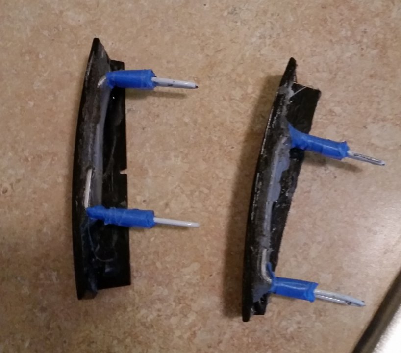

    Brackets, coat hanger, hot glue and dremel. Ended up taking the bluetape off. It was originally for the first unit to prevent it from pushing all the way in. But the way this unit is designed, it stops the bezels from pushing in so it worked out perfectly. The color doesn't match too well, I think I will wrap them in CF or something.
    Without Brackets:
    With Brackets:

    How is the viewing during the day when the sun his the screen?
    SM-N900T ?
  6. chanh55
    chanh55 Junior Member
    Oct 21, 2013
    Vancouver, Washington
    Even in full sunlight, it is very clear with no viewing problems at all. It's a lot clearer and brighter than the climate control screen. Very much like the first picture I posted. I'm not surprised how clear the screen is in the sun. I have a Samsung S5, and in full sunlight, if I put my screen to full brightness I can see it as clear as if it were nighttime, even with my polarized sunglasses on.
