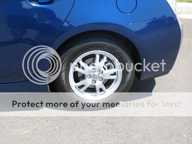

    BOO! Wow, that get tiring, but I must say, you redeamed yourself by offering the link to lower priced ceter caps, so you are OK by me. Now, drum roll please, for IMO, the most Be A Youthful stock Prius rims to grace the planet Earth.
    [IMG]
    [IMG]
    [IMG]
    Weather you like the rims or not, you've got to love those sexy four wheel disc brakes being showed off and very well cooled.
