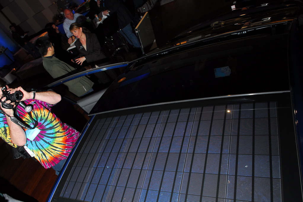

    Having just cleared 3 inches of snow and ice off my car's roof, for those of you in Detroit who have seen the 2010 model in person, I wonder does the solar panel have some sort of glass or composite cover on it? Would there be any issues with taking an ice scraper or brush to it?

    The solar panel is flush with the roof, and resides just behind the moonroof. The solar panel is only sold as a package with the moonroof and electric ventilation. The purpose of the panel is to provide electricity to run a ventilating fan, so on hot days the interior of the car is kept cooler, making it more comfortable on entry and also reducing initial A/C loads. This package also includes remote start air conditioning that can be run on battery alone.
    It appears to be covered with some sort of glass that could withstand a standard snow brush or scraper.

    The solar panel is 80W. It does not power the AC, it powers the ventilation fan that will run automatically when cabin temps rise (maybe based on outside temp, I'm not sure). The air will, presumably, vent through the battery vent.
