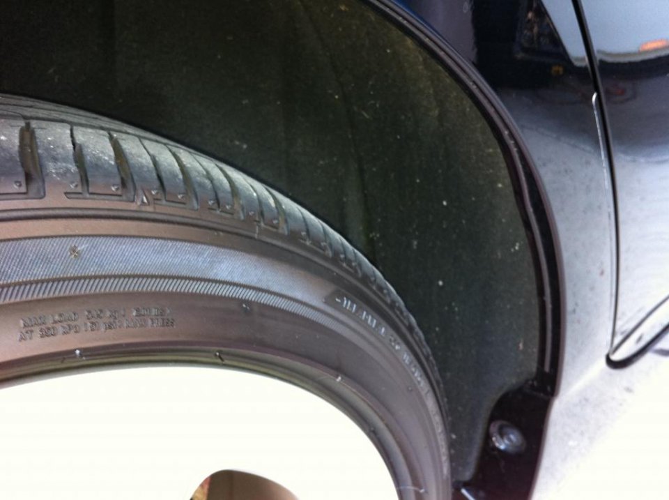

    What is this rear wheel well liner you speak of? I have some felt liners in there that attract a lot of dirt. Is this what you are referring to? Are they there to reduce road noise?

    Probably noise reduction, but I can't be absolutely sure. But they do look better/more finished than without the liners. See Should the rear wheel wells look "unfinished"? | PriusChat Those with the lower trims can probably order and install them for the more finished look.
