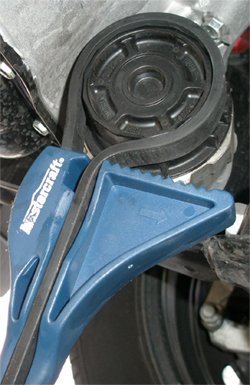

    How about a universal wrench. Once size fits, most all.

    When the service department overtightened mine one time I tried a wrench like that and could not budge the filter. The rubber belt just slipped no matter how hard I tried. With normal tightness it should work fine.
