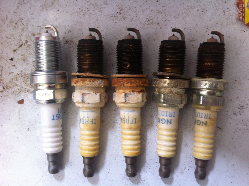

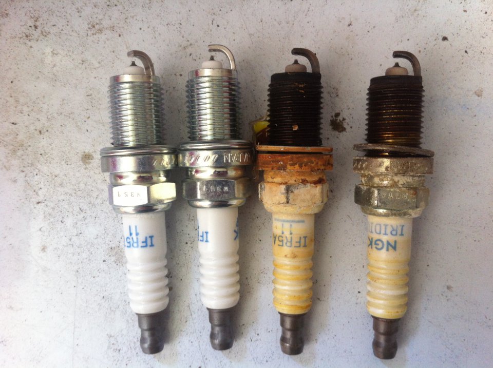

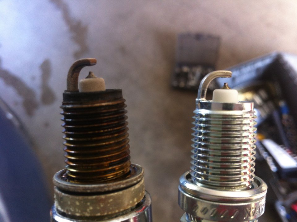

    Bought my first Prius yesterday and then it was off to NAPA this morning to pick up 130 dollars worth of new parts. Everything looked fine except the spark plugs. They looked like they are the original ones.. Kinda rusted and pretty corroded.. Must have the whole 94,000 miles on them. So just reminding everyone that even though you are buying a 'new' used car, still perform maintenance so you know when it was done last!

    Yes, that is because water got into two of the spark plug wells. To reduce the likelihood of a repeat occurrence, put some black sealant on the plastic cowl center seam. Water can drip down that seam into the engine compartment and land on the cylinder head cover. If enough water gets there, some may leak past the igniter O-ring seals into the spark plug wells.

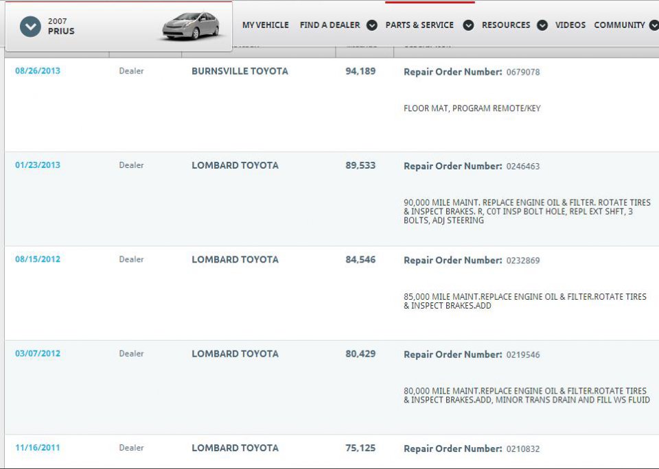

    I just looked up all prior maintenance of this car on the Toyota Service History website.. I lucked out big time, the previous owner took his car in every 5000 or so miles and had regular maintenance's done to the car. Looks like the tranny fluid was just done at 80,000. So I'm only 15,000 miles in on this change. This is so good to see.
