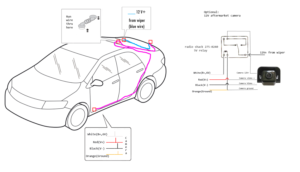

    My 2012 already pre-wire from hu to the hitch. I just need camera and 3ft wire(4wires), this all. But I heard one person who need to wire-up the driver kicker panel but I don't need.

    Ray,
    Where in the hitch? Do you have a picture of the harness and the wire colors?

    ray6088 Junior Member
    Start a Conversation
    Member Since:
    Jun 22, 2012
    Posts:
    55
    Likes Received:
    Your Vehicle Year:
    [IMG]
