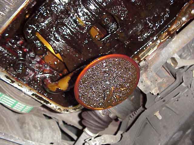

    I guess the simplest way to answer your question is thus: All oil whether conventional or synthetic has an additive package added to a base stock oil. These additive provide: viscosity, corrosion inhibiting, anti-oxidants, friction modifiers, anti wear additives, cleaning (detergents) and many other things. What goes bad in the oil is the additives which is exactly what protects the engine. The base oil is just a carrier for the additives. When you simply add a little oil to the old oil you give a little bump to the depleted additives but not nearly enough to protect the engine from damage and sludge buildup. The old oil has also lost ability to resist sticking to the engine parts.
    The car burns oil because the lifters are loaded with carbon and the piston drain holes get clogged and the oil cannot drain into the crank case so it gets burned off.
    This is what happens to an engine when it is not properly taken care of. You end with an engine that could easily go 300-400k miles that is trashed.
