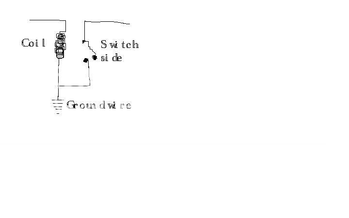

    You actually have a couple of options:
    1) You can simply leave the lights on all the time....(Easiest solution)
    2) I have installed relays on several Prii that were sold to customers who were planning to drive them home to Canada. The relay was simply wired to provide a ground source for the headlight switch wire when the ignition was turned on. (Very simple to create and install)

    Jayman, do you have a simple diagram to install the automotive relay for "ignition on lights"? Wire location, color, ect.
    I like that idea much better than leaving the switch on all the time.
    I appreciate your input.

    Sorry, bear68, the previous post was for you. Any help with install would be nice.

  13. Bear68
    Bear68
    Expand Collapse
    Member
    Mar 9, 2007
    373
    69
    West Palm Beach, FLA
    Here is the basic design that I have used. A standard 12v relay available from any parts store has 5 teminals. You will use only four of them. I prefer to connect one side of the coil together with one side of the switch and run both to ground. The other side of the coil is connected to an ignition power source and the other side of the switch is connected to the wire coming into the headlight switch. [​IMG]Please forgive my total lack of artistic ability.
    If you goto the combo switch connector that plugs into the headlight switch portion, connect to the red wire at pin 20. That wire goes to the switch side. For the ignition switch power I have used the Violet wire in connector 1G pin 6. 1G is located in the top row of plugs on the driver's side junction block just below and slightly left of the steering column. It is a 14 pin connector and I believe it is white. (That violet wire BTW gets power from the 10a gauge fuse and goes to the master power window switch. I tried to upload a picture of it but it wouldn't load since I get my info from TIS. This relay only uses four wires, two of which join into one and go to a good ground. When the ignition is turned on, the violet wire provides power to the coil to close the switch. The closed relay switch then provides ground on the red headlight wire to turn on the headlights.
