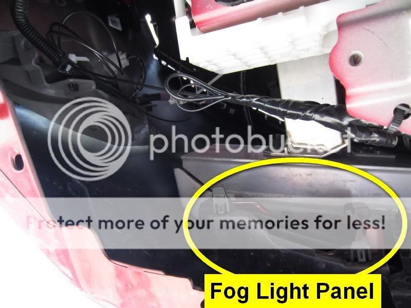

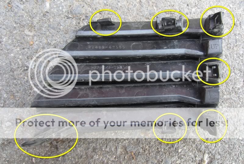

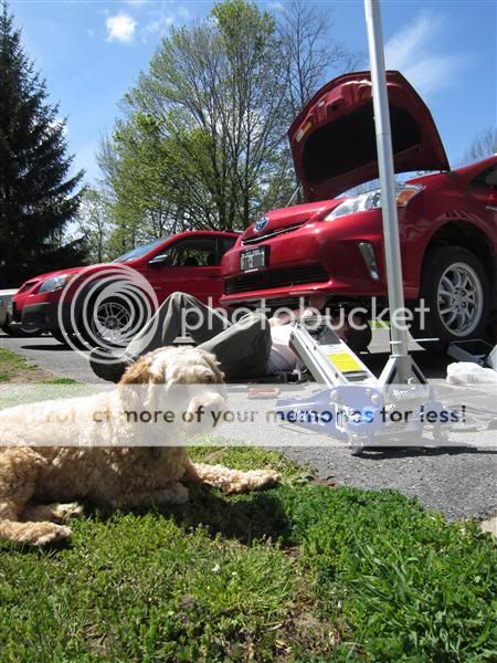

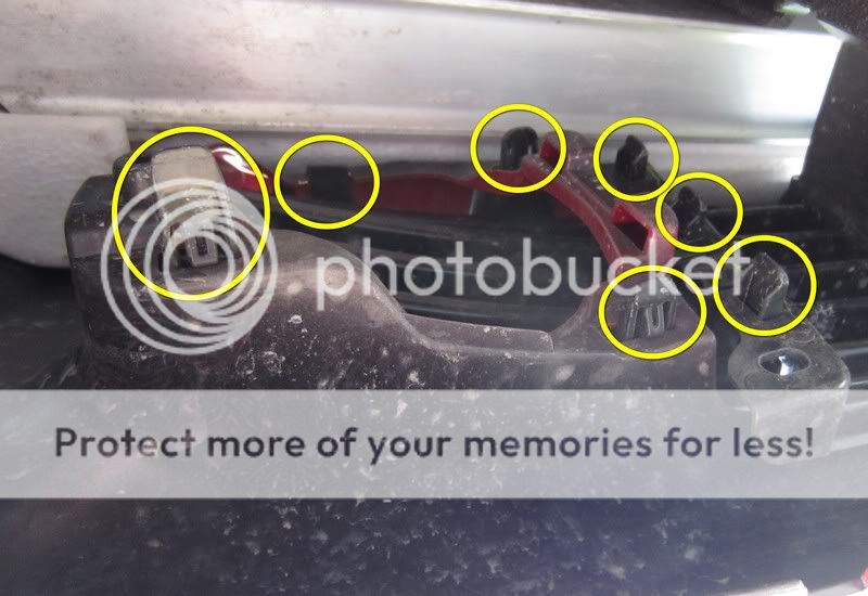

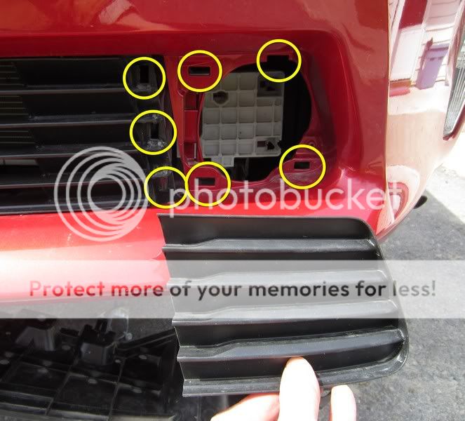

    Nothing installed or ordered yet, but I had my v raised yesterday anyway, so I took some pictures of the bumper insert. This is the insert where the fog lights are located in the fancier models, and where I'll likely install my DRLs if/when I figure out a good system. Figured this might be helpful for anyone who wants to swap out a fog light bulb or add their own DRLs/fogs. I'll probably end up installing something very similar to what I had in my Scion - link in OP. But I may be able to tap into a fuse slot (currently empty) that's labeled in the manual as "DRL". We'll see!
    Re. the fog light bumper insert, there are 7 (overkill?!) clips that hold it in to the bumper, circled in the pictures. To access the rear of this insert, you have to take off the big sheet of black plastic under the front of the car. This is held on by about a dozen screws and bolts with 10mm heads - I recommend a drill with a 10mm socket attachment to speed up this process. Once you get this big ugly black plastic sheet off, there's actually quite a bit of room behind the bumper insert, and it's just a matter of releasing all 7 clips for each insert, and pushing it out the front of the bumper.
    I took pictures with a ruler to document the size of the insert (and therefore the size of DRL housings that would fit in it), but text is probably more helpful - it's about 4-1/4" tall by 5-1/2" wide.
    If you want to install a thin rectangular LED in the center lower bumper grill, the slots are about 3/4" high by 4-1/2" wide.

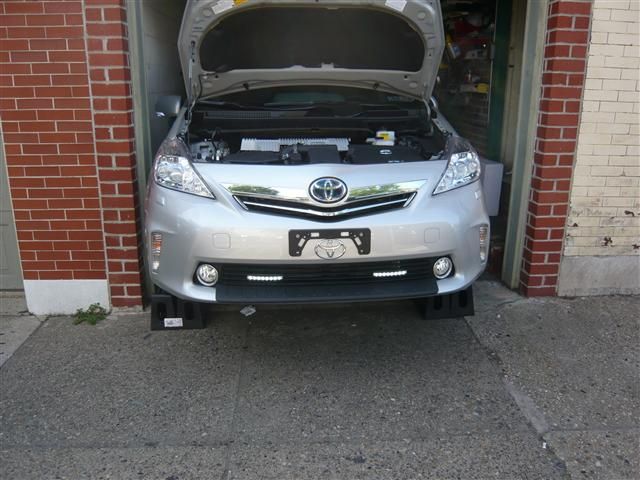

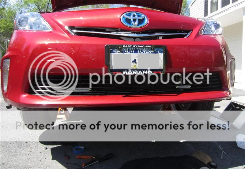

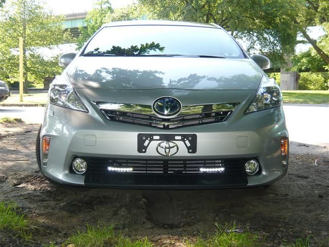

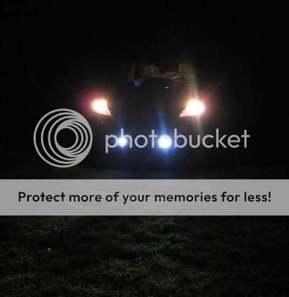

    OK, I did it! I now have LEDs on my v that are on whenever the engine is on. :nod:
    I'll go ahead and start with the finished pictures, and then if you're interested in my installation method, read on.
    [IMG]
    [IMG]
    [IMG]

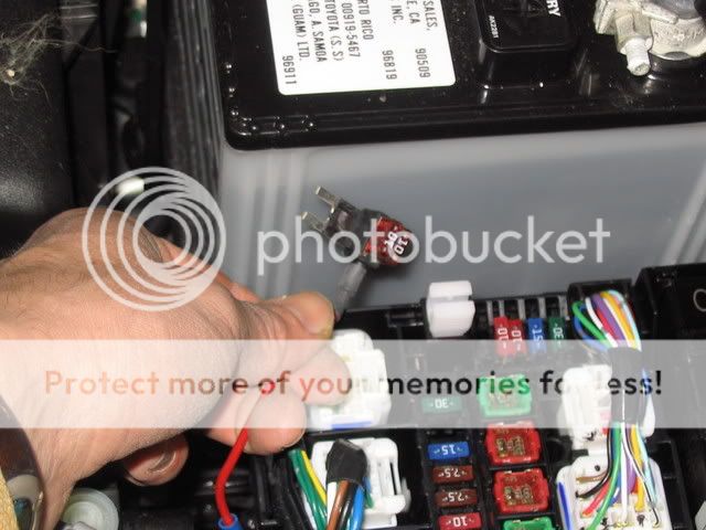

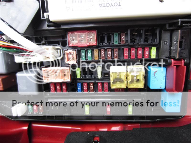

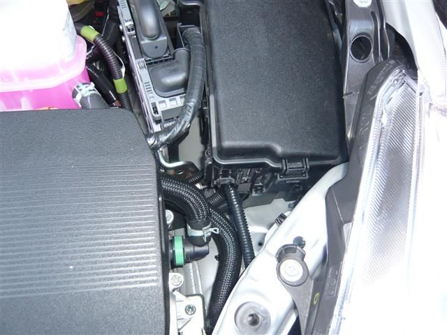

    I used the same installation method for these that I did for a pair of LED DRLs I put in a Scion xD. First step was to identify a fuse in the engine compartment that was ON when the car was on/READY, and OFF when the car was off. Would you believe that out of all these fuses, there are only about 5 that are OFF when the car is off? Almost all of them read a full 12.6V when the car is off.
    [IMG]

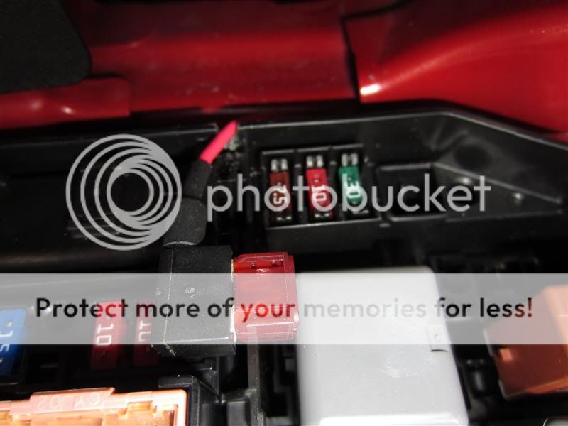

    Of those five, I think only three come ON when the v is in READY mode. I picked fuse #28 (PCU, Inverter & Converter). I tested this both with and without the ICE running, and it was consistently on when the engine was on.
    I used a BUSS Mini Add-A-Line (also called a "Fuse Tap") from Advance Auto Parts (Part No BP/HHH, $7). This allows you to tap into an existing fuse jack, keep a fuse of the original amperage, and add a new fuse. (This pic is from my Scion; accessory is the same.)
    [IMG]
    Note that the plug on this is the size of a "Mini" ATM fuse, and the fuses that come in the Prius v are "Low Profile" ATM. The non-low profile "Mini" fuses still fit in the v's fuse box; they just stick out farther. Also, this accessory only accepts "Mini" fuses; low-profile won't fit. So you do need two "Mini" fuses in order to use this, and max capacity is 10 Amps each. Both 10 Amp would be fine, but I used a 10AMP for the original circuit and a 7.5AMP for my new circuit.
    Here it is plugged into my v:
    [IMG]
    I trimmed a little slot in the side of the fuse box for the wire to exit, and still allow the lid to close.
    [IMG]

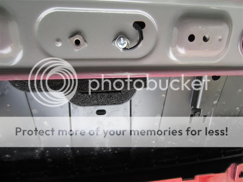

    The wire coming out of this accessory becomes the hot wire for the bulbs, and it ends in a little crimp connector. I crimped in a new piece of wire, and ran it down to the spot behind the lower grill where I wanted to install the lights. Here I am hard at work, with assistance from helper-dog Leo:

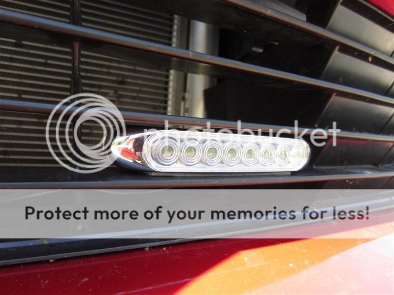

    The lights I used are fairly cheap, generic 8-LED DRL fixtures. $20 from ijdmtoy.
    (EDIT: I do NOT recommend these. One failed after less than a year. See update post below.)
    These come with a pair of thin (20-22ga?) wires hanging out the back, and some little pieces of double-sided tape for mounting. The white wire on these fixtures is hot, black/white stripe is ground.
    I chose to mount the lights in one of the lower grille openings (see pic at top), using some heavier-duty outdoor double-stick tape that I had purchased previously. (The tape that came with these fixtures didn't exactly inspire confidence.) I didn't want to cut any new openings, or do anything too permanent at this point, so I can remove these later and replace them with better bulbs if I choose.

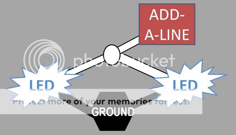

    I connected white wires from both bulbs to the hot wire coming from the fuse box, and black wires to a common ground. See diagram below. My ground point was an open metal nut that was welded to the frame - this is approximately in the middle of the car, under the bumper, facing the ground.

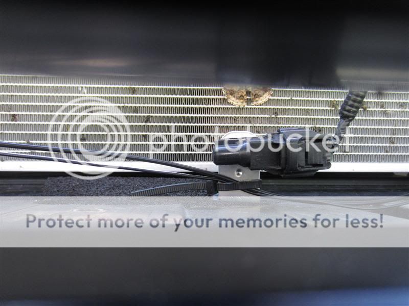

    Wires from the passenger-side light ran between the grill and the radiator - I secured them to this little probe mount.
    [IMG]
    I secured all connections with crimp caps, cable ties, AND electrical tape - trying everything short of solder to keep connections from working loose.
    Not a very photogenic installation - perhaps a simplified wiring diagram would help:
    [IMG]
    Overall, I would say I'm content with these lights. Not thrilled, but also not disappointed. They were never intended to light up the road for driving; I just wanted to increase my visibility to oncoming drivers, especially when my main headlights are off. I think they accomplish that purpose, especially at dusk or in shadows. They do provide a little bit of light, maybe useful for pulling into your garage if you don't want your big headlights on for some reason.
    They look kind of like a cheap add-on, which they are... But when the car's not jacked up, and you're looking down at them from a normal standing height, they're really not obvious or obtrusive.

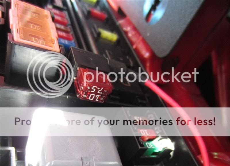

    While I was installing my DRL, I poked a 16 gauge wire inside the fuse box hoping to find the opening so that I don't have to cut the casing. Sure enough, next the the BIG white wire on the bottom right as seen in pictures below there is enough opening to snake the wire through. With wire loom added, the new wires for my DRL blended in with the OEM just fine.
    [IMG]
    [IMG]
    [IMG]
    The light has 3 wires, the extra is for the turning signal which is once activated will flash the amber LED alternately with the white LED.
