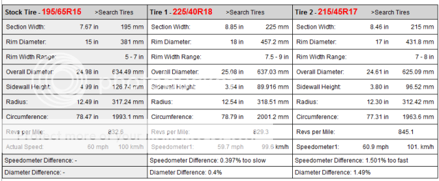

    Here the wheel size option. It from 1010tires.com
    [IMG]
