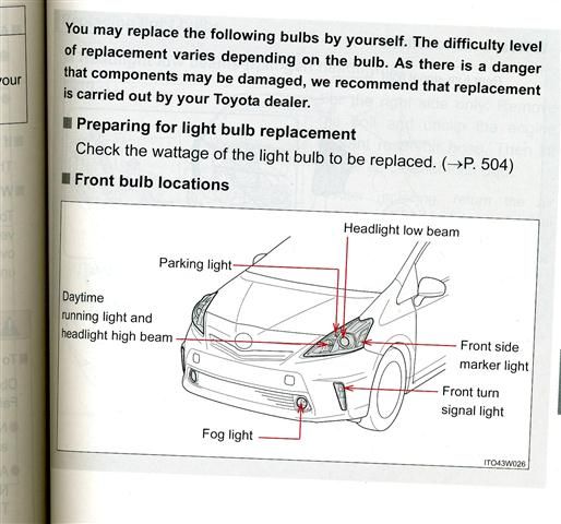

    Many said there is no DRL for the V in the US but when I browsed through the manual I saw the diagram below clearly shows the DRL: (ATP package of course)

    Ah yes, nice pic of p 419 of the Owner's Manual. I went looking for "if equipped" qualifier but could not find it anywhere near that page. I guess it is best explained by this post;
    From this thread; http://priuschat.com/forums/prius-v-main-forum/107608-manual-not-accurate.html
    Or maybe they just didn't want to create a new version of the Owner's Manual for Canada, where they do get DLR on the Prius v (wagon).

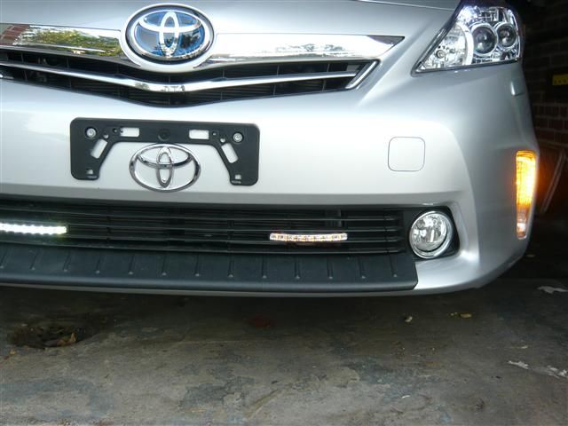

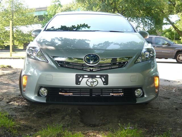

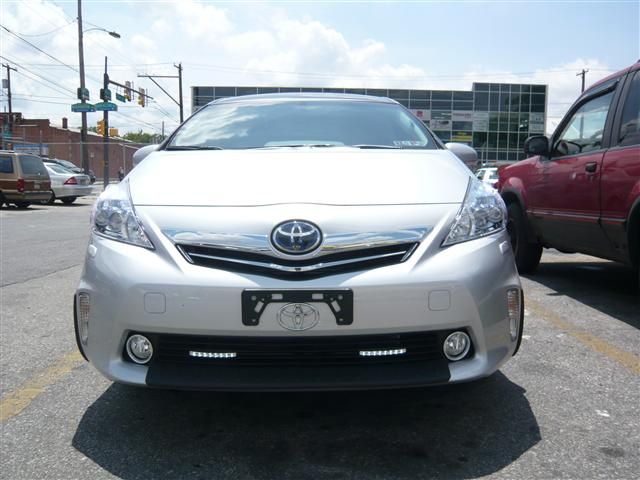

    HID Ready Projector Fog Lights w/ Halo CCFL Angel Eyes | eBay
    I saw something similar to the above, so you can just replace the OEM fog lights with them then run one extra wire for the outer ring DRL light.
    Now you have BOTH.
    Better yet found the ones below later:
    http://www.ebay.com/itm/2012-2013-P... V&hash=item3cc52c427f&vxp=mtr#ht_5984wt_1185
    http://www.ebay.com/itm/2010-TOYOTA...es&hash=item27c06fb380&vxp=mtr#ht_1091wt_1185
    I have to make sure which one will fit though.
    [IMG]
    [IMG]
    [IMG]
    For now this will do for me.

    If you mean the front license frame, it came from the factory like that and I don't need the front plate in PA, but now I have the one below:
