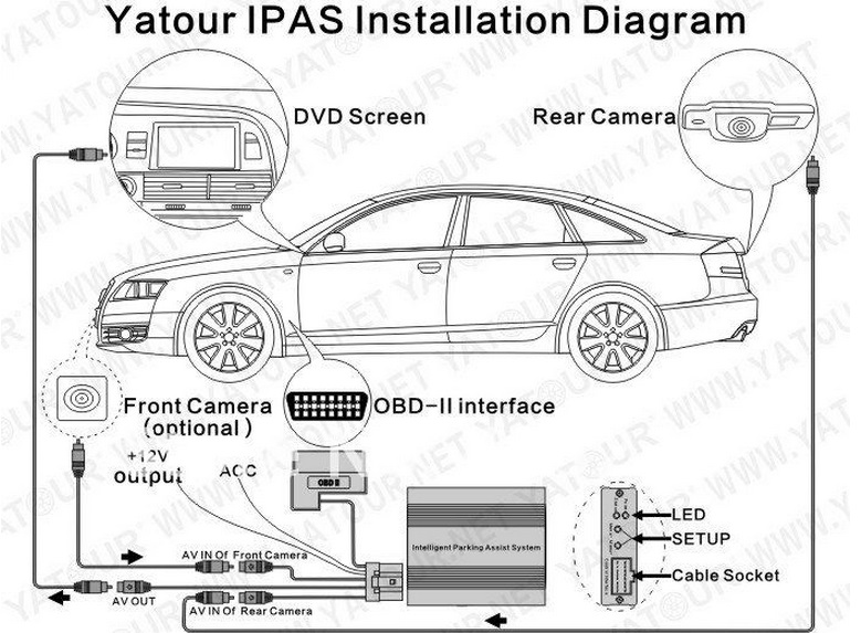

  10. sushiDot
    sushiDot Junior Member
    Jul 21, 2013
    36
    Ok so the camera i have just has some lines built into the camera feed,
    there is no onboard IPAS that it interfaces with?
  11. NoMoreNow
    NoMoreNow Member
    May 13, 2013
    167
    102
    SF Bay Area
    Yup, the one u have just Reference Lines built-in, I have the same one too.
    But u can add the IPAS module ($80-$115) to your aftermarket headunit and change camera again with Non-Reference lines.
