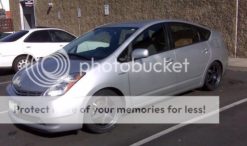

    Here is the latest pic we have of the local Prius we used for Testing.. now sitting on a set of Buddyclub P.1 SF Racing wheels :D
    [IMG]

    Looks good!
    Do you guys have any hub to fender lip measurements compared to stock?

    Your Vehicle Year:
    and what are the OEM Prius spring rates for comparison?
    Also, the Buddyclub wheels and tires... what wheel offset and what wheel and tire size are on the Prius pictured?

    17X7 buddy club sf challenge 5X100 43 offset
    Tires are Nexxen 205/40-17
