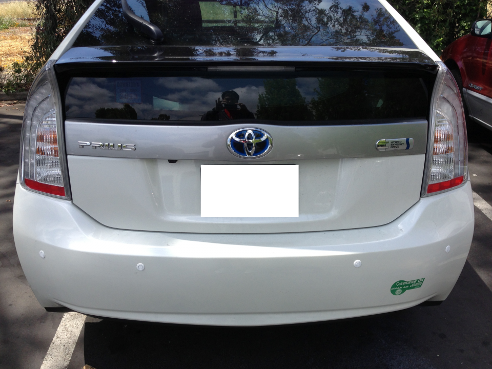

    I think I did mess up the sensors when I used the touch up to paint on them. I removed the paint and the sensors work the way it should be. I just leave them as black now.
  17. evebill8
    evebill8
    Expand Collapse
    Member
    Oct 25, 2011
    139
    16
    San Jose, CA
    I found the sensor with white color probes. Platinum Autoworks, Patrick, helped me to replace the black ones with the white ones. It looks great now! photo.png
