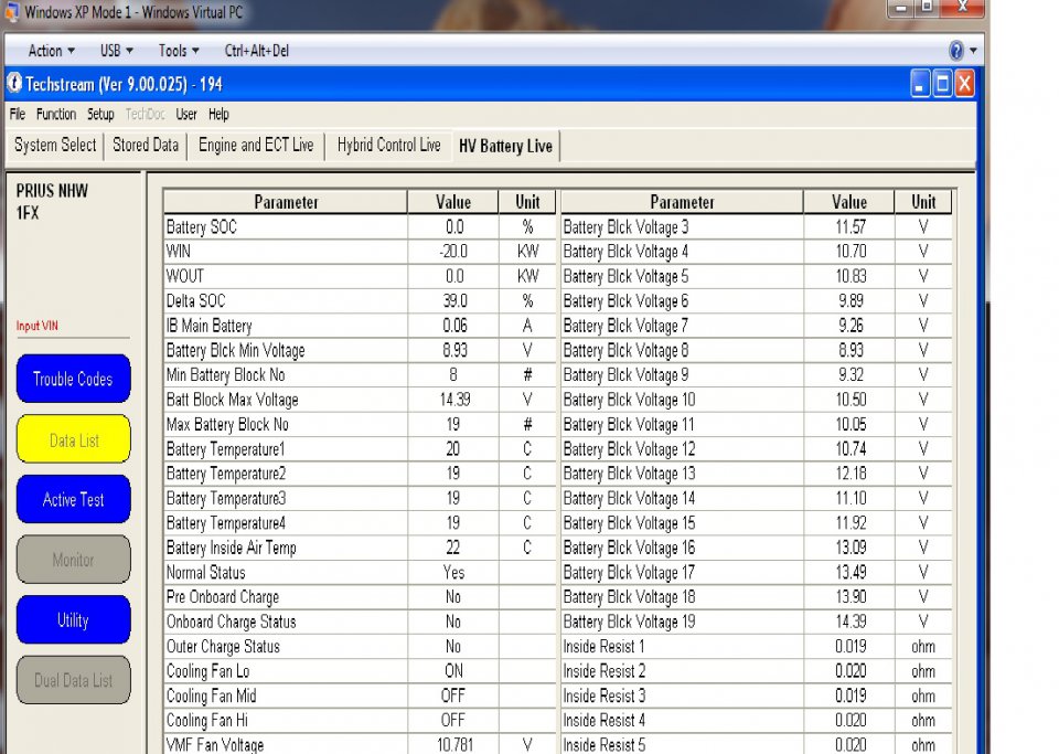

    Long story short, I had run down the HV battery in my 2001 Prius. It turned out to be a faulty wire to the ignition system of the ICE. While diagnosing, I let the HV battery drain, at least I think I did (Please see image of my HV battery specs). My question is, How can I charge the HV battery? I read Öut of Juice" but do not have the charger. My question is can I make one? Thanks in advance for all of your help and sorry I did not see a Gen 1 prius section so I posted here. If there is one, I apologize.

    I think your battery is past recovery given the very low voltages recorded in blocks 3-15. You would be better off making a decision about buying a new or remanufactured battery, or buying 38 2G or 3G battery modules to swap out the original modules.

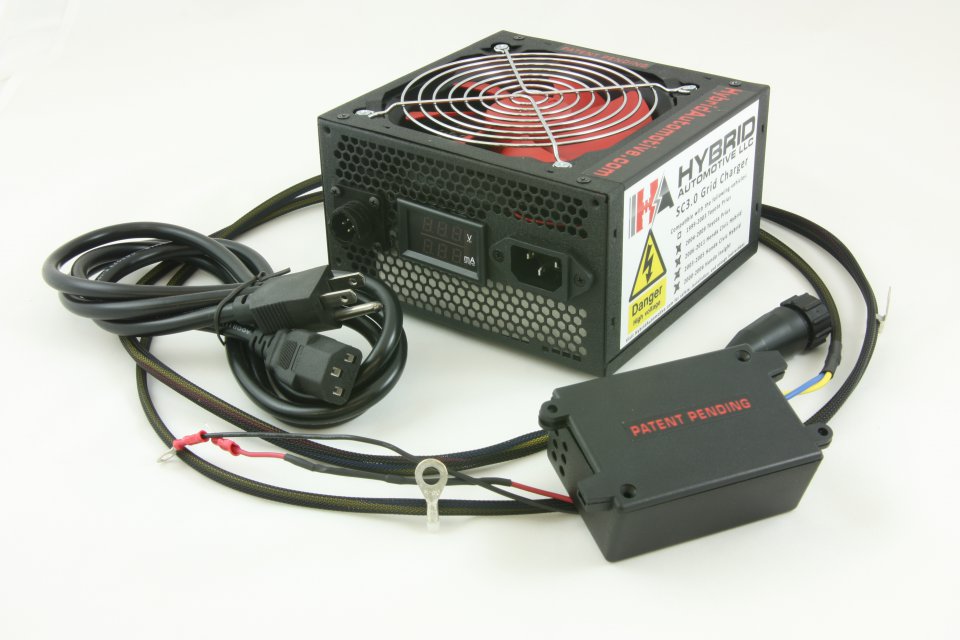

    Our patent pending Prius Grid Charger would be perfect for charging the pack and allowing you to start and drive the car. It is the only system available that safely allows rebalancing the entire battery pack cells at the while still installed in the car.
    It won't resurrect cells that have already failed, but if imbalance and/or discharge is your issue, this will fix it. The 2004-2009 Prius system is available now for $399, and will be reflected on our website and eBay in the next 48 hours.

    so this is what confuses me a little bit. I have the 12 volt battery charger connected to the auxiliary battery and the key on. After a few hours of this my HV battery cells are all now stedally increasing. If I leave the 12 volt charger on the auxiliary battery will it somehow charge the h_v battery cells. my lowest h_v battery cell is now at 10.1 volts and my highest is 14.44. My battery soc is now at 4 percent in my delta s o c is at 20 percent. is there anyway to speed this process up? this is now much higher than what I originally started with so I'm thinking there's a chance or maybe not

    The 12V charger is doing nothing with regards to charging the traction battery. The traction battery block voltages need to be within 0.3V of each other, or else the traction battery ECU will log a fault and the car will not start.

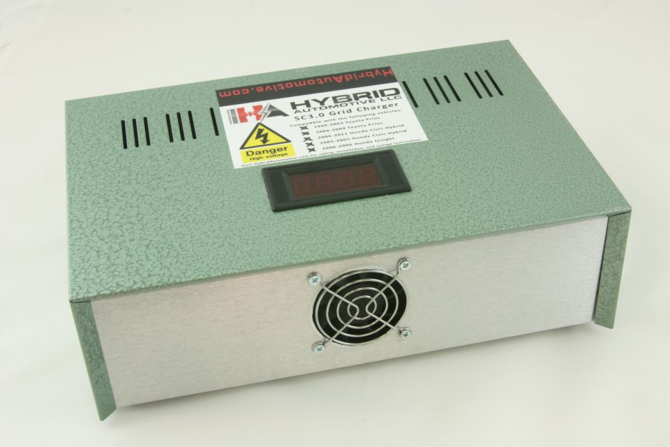

  14. jeff652
    jeff652 Senior Member
    Feb 6, 2014
    597
    623
    Idaho
    Good point, I didn't catch that. The 99-03 Charger looks like this (for now):
    They cost a bit more, $549 at present, due to the necessary case fabrication labor and additional internal components required to get to the 340V unloaded required by the larger hybrid batteries. Our Mechanical Engineer is already working hard on a new case that will significantly reduce the price. This new lower priced version should be to market in July.
