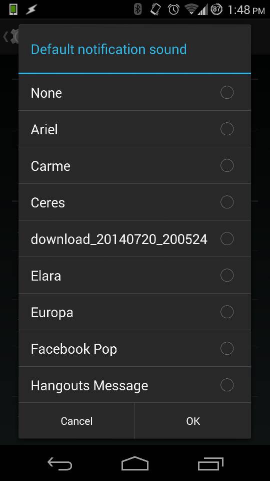

    hmm...I think if you lower the "notification" volume in your Android sound settings, this will go away. If it is, in fact, the phone changing the sound.
  10. rxlawdude
    rxlawdude Active Member
    Mar 31, 2011
    701
    219
    So Calif
    2015 Tesla Model S
    Not sure about that, unless there's a "none" option. Low volume alerts would still interrupt the BT stream, regardless of whether you hear 'em or not.
    thenapolitan likes this.
  11. thenapolitan
    thenapolitan Junior Member
    Aug 19, 2013
    Rochester, New York
    Ah yes, good point. I guess you could install the Tasker app and set an option to change your notification to "None" only while it is connected to the Car Audio Bluetooth. Hmmm... I'll try that this afternoon and see if it works...
