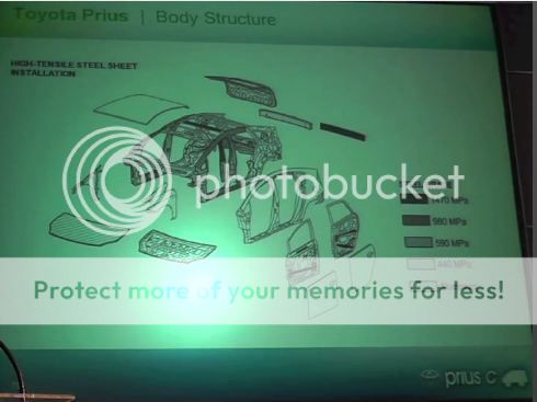

    I found it on the Toyota Technical Presentation video. But all I could get is a screenclip, if I had the PDF it would be much better resolution. I'll keep looking.

    Thanks old wolf, I saw this early on and liked it as well.

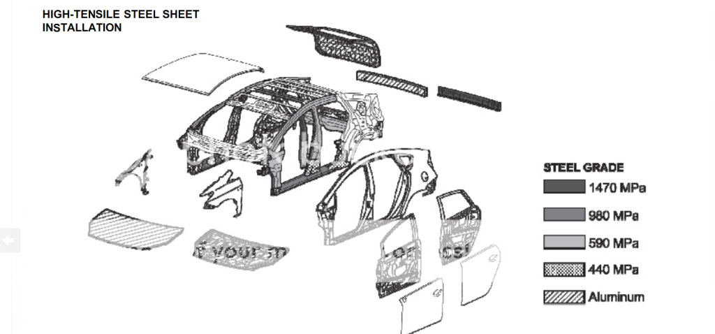

    Does this help?

    I located a better one. It looks like the hood is aluminum and maybe the vertical portion of the rear hatch. I'm not sure about the roof and door panels which show white in the drawing.

    See my post above. A magnet sticks to all the exterior body panels, including the hood, the hatch, the roof, and the doors. Perhaps some of the interior panels are aluminum.

    Okay, all exterior surfaces attract a magnet just like ftl said.
    BUT, the hood and hatch on my GEN2 do not attract a magnet so at least I know that they are aluminum.

    It's hard to see exactly what's where from the diagram. The image came from the technical presentation PowerPoint/PDF, both of which are linked from this post in the main forum for the C, but the documents are hosted at Scribd and it now requires a paying login to download them. The originals might show a clearer image.
