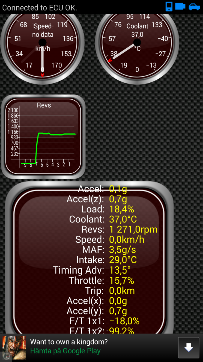

    I bought a no-name module on sale from Kjell & Co. Here in Sweden. I tried it with the android app Torque, and I get some numbers from the car.
    But I was hoping for more information. It's possible to add ODB2 PID in torque. Where can I get that information?

    Take a look on this page, specifically at two links: the NHW11 vehicle database (which is in generic XML form that can be exported into the formats different apps expect), and the Torque exporter (which is supposed to generate the kind of file that Torque is able to import).
    As it says, I didn't have the Torque app to test with, so if the exporter isn't generating the right format in any way, I'd be interested in knowing.
