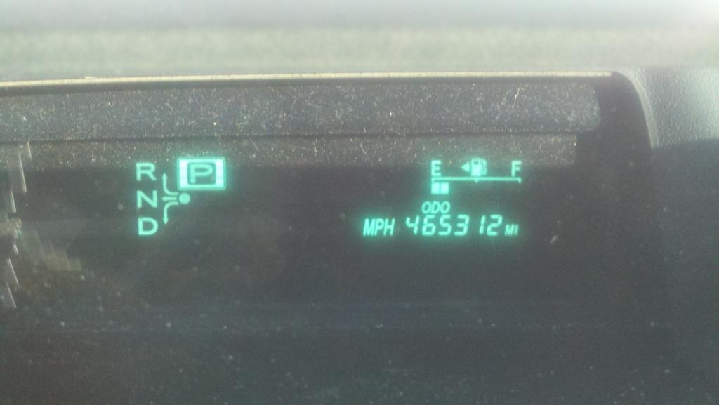

    Wow! over 500,000 miles, seriously! Is there any documentation on that perhaps an article written and post on this subject of high mileage Prius cars?

    2 fas 4 u went over 465k miles with original HV battery before trading in for Prius v. Check out this thread.
