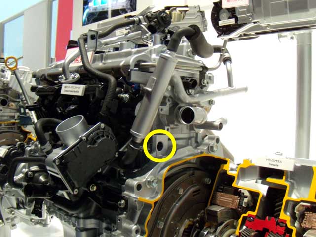

    It should work, the c uses basically the same engine as the gen 2.

    So it will work.. Just in a different spot?

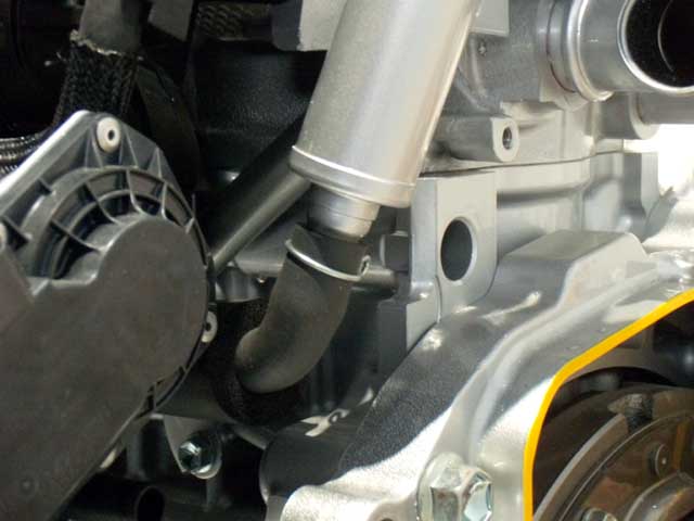

    I installed mine last week. Purchased from the PriusChat shop. Installation takes about 20 min, you need to remove the tranny breather valve (or whatever it's called) to get the heater cylinder to line up with the cylinder hole. Then it just slides in no problem.

    Also, the heater installs in the nearly identical spot as the images posted above.

    Okay, after taking a look on the car this actually looks really easy. I am going to order the heater today. I will post some pics showing how to install when I'm done for anyone who wants them. But I think if anyone takes a look under their hood and compares it to the above pictures that should be enough.
