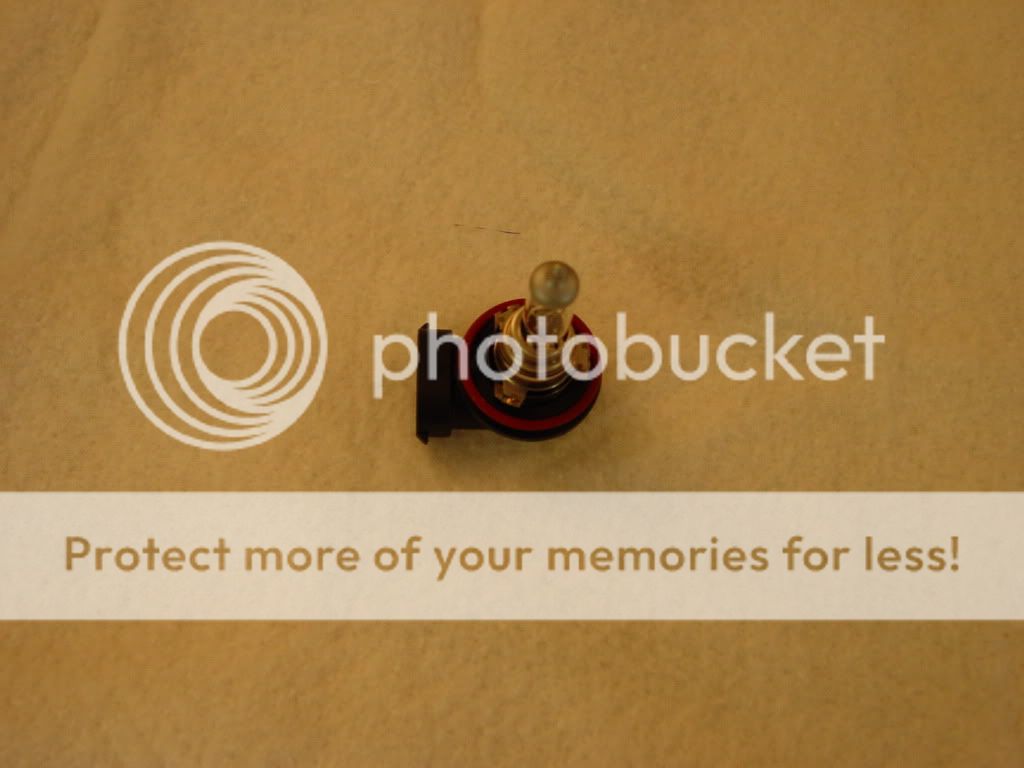

    yes, that is H11 bulb. 55Watt.

    But the bulb is not 55 watts it's 19 watts. I could not find the bulb in any of my automotive lighting catalogs at work.

    the bulb looks like H11, but 19W. lol haven't seen this bulb before.
