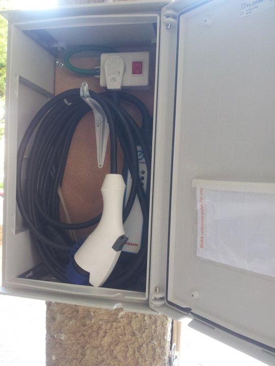

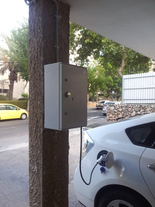

    Soon I'm buying a 5"x5"x24" plastic outdoor enclosure with cover to hold a duplex box with 20 amp switch and 20 amp outlet. Then I can use the switch to power the outlet, plug in my Kill A Watt in the outlet, plug a right-angle appliance cord into the Kill A Watt, plug the charging cable into the appliance cable, and mount the CCID (Charging Circuit InterruptingDevice) of the charging cable in the box, to keep it out of the weather.
