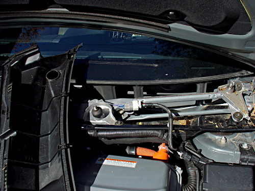

    Just found this photo
    [IMG]
    from here:
    Prius heat-efficiency mods
    I assume those are the rectangular holes I need to put screen on? What is the frame made of? Metal or plastic? I would like to get as much planning done as possible before actually opening it up. Thanks! :)

    Yes. The frame is sheet steel, so you will have to drill small holes and use self-tapping metal screws to secure the screen.

    Thanks! I was wondering whether sheet metal screws would be secure enough in a car. Would it work itself loose with all the vibrations in the car?
