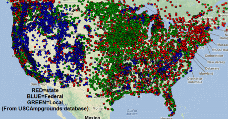

    I duno . . . how many RV parks are around. That's just a fraction of a start as there are lots of other entities that can give you 240v. Here's local state federal camp grounds of which most have 240v for RV folks (doesn't include private camp grounds, which would more than tripple the quantity):
    cwerdna and inventor00 like this.

    can you use these outlets without staying there?

    many will - if you're truly interested just call ahead. Some will charge you a token amount while others will let you charge for free. RV parks helped Tony Williams become the first Leaf to travel from Baja California /San Diego border all the way to Canadian border.

    that's pretty cool! would definitely make the evse upgrade worthwhile.
