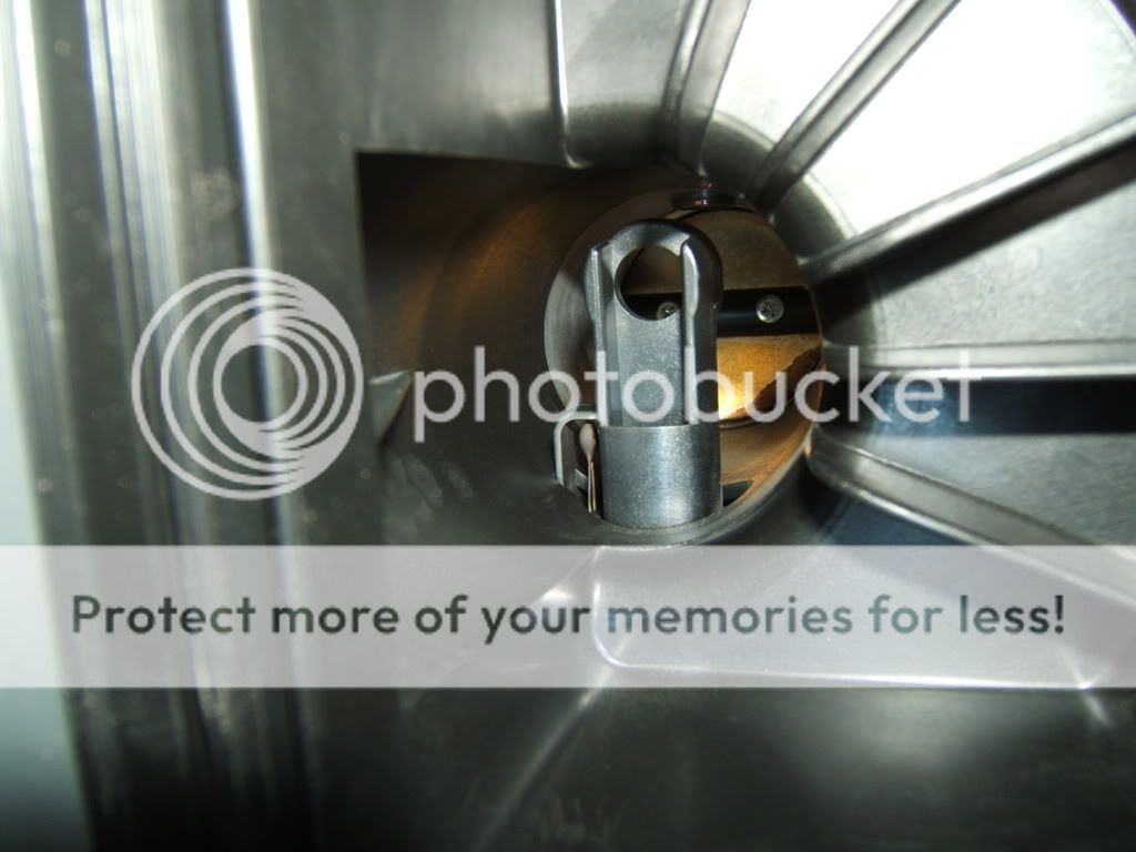

    So I had a headlight bulb burn out on me. I change my bulbs myself and when I change them, I have to take the entire headlight assembly out. I don't have little hands to get back behind the headlights to replace the bulbs, so I remove the entire assembly.
    When I took the passenger headlight out, I looked at and examined the air intake. I followed the tube, there's an small opening for air to be taken in the engine compartment (Looks like a snorkel). If you follow it further the intake tube passes into an opening which leads to a space forward of the front right wheel. (Passenger side for US models.) There is a huge baffle in this space. (Large white box) I removed it to examine it. it's a large box with several chambers in it, and there are 4 or 5 small holes in the bottom (these holes is where the air is drawn through - Extremely restrictive)
    I did a search and found this Priuschat post
    http://priuschat.com/forums/gen-ii-prius-technical-discussion/97156-whats-air-box.html
    Other searches about Cold Air Intakes,showed that the Prius doesn't like CAI's and has resulted in errors in the Prius's electronics, and irregular MAF readings, which doesn't allow the ICE to run. So I wouldn't recommend a true CAI, but removing the baffle might be an option?
    As I was working on the car I was thinking, why not try to drive the Prius without this restrictive baffle instead of a CAI?
    So I removed the baffle last week, and since then I've noticed that hills that the Prius really struggled to drive up before, had to problem going up now. Also the throttle response seems smoother and I've noticed I don't have to mash on the gas as much to get the car going. I've noticed a slight increase in Fuel economy ( like 1 mpg more... but still an improvement.)
    Has anyone else tried this and and any issues, or noticed any improvements?
    Anyone else wanting to remove the baffle the first thing to do is remove the right side / passenger side headlight.
    Here is a link to a video that shows how to remove the headlight assembly:
    (The passenger side requires that you remove the intake snorkel by removing one small push pin/clip that holds it in place, using a flat head screwdriver, gently pop the push pin up, and then remove the clip.)
    Once the headlight assembly is out, remove the air intake pipe, then you will need to remove the bolts that hold the baffle in place (all are 10MM). Two bolts from the top, one nut in the front, and another bolt by the wheel well plastic liner (to remove this bolt you'll need a flashlight to see it, a ratchet, 10mm socket, and extension to reach it and get it out.)
    Anyone who has removed the baffle, or wanting to do this mod please post your questions, results, issues, or successes.

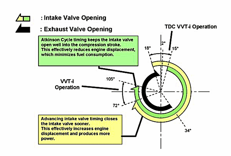

    All modern Atkinson cycle engines have delayed intake valve closing that allows fuel/air back into the intake tract. I may be wrong, but I think the MAF measures air only, it has no idea how much fuel is in it. (if any Atkinson engine had Direct Injection this would not matter, but they do not) Even if it has a 'cold' source, since 1/3 of the mixture has already been in the cylinder once, it is no longer cold, I believe. To improve throttle response, put it in Power mode.
    [IMG]

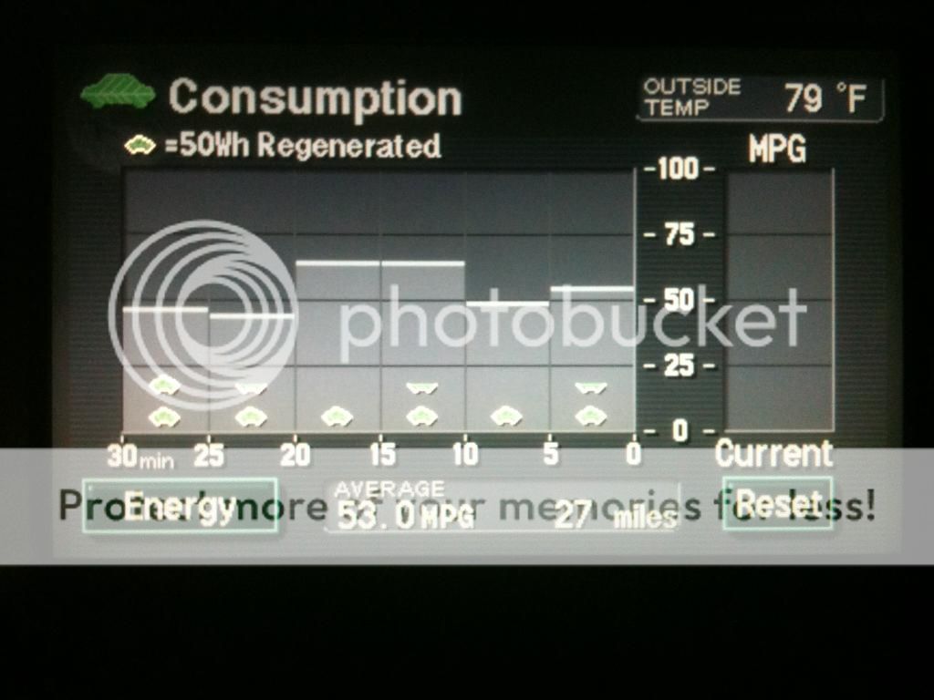

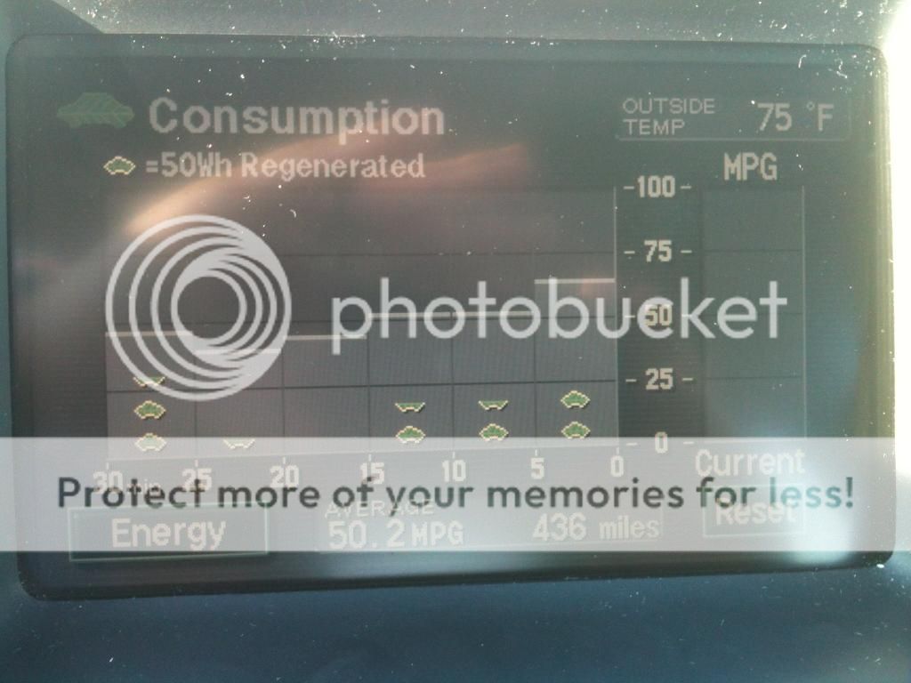

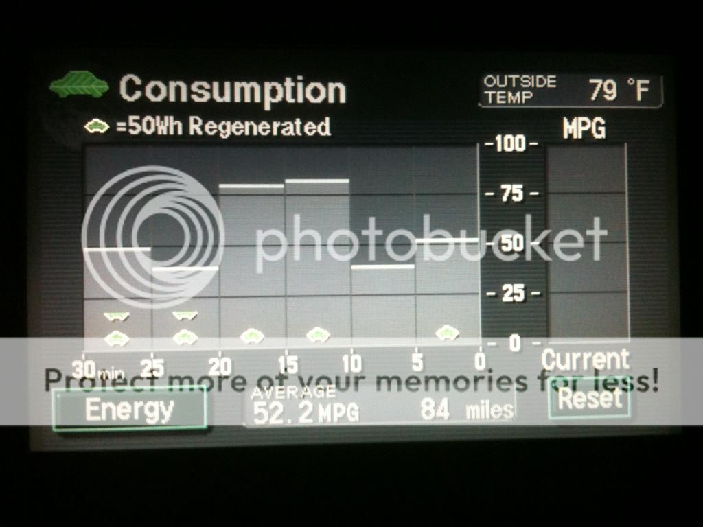

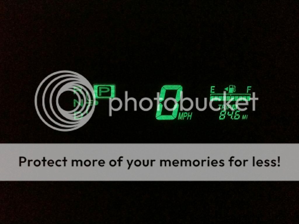

    Here's a picture of my trip log I drove 436.8 miles, still had gas left, but I always fill up at Costco because they have the lowest price of gas in the MD/DC/PA/VA area. [IMG]
    [IMG][IMG]
    Here's a pic from my drive from the Costco Gas station to work Ave MPG = 53.0 over 27 miles.
    [IMG]
    Here is a picture from work to home, still impressive MPGs.
    [IMG][IMG]
    So all of you who are sending me PM's saying that I'm stupid, or that I'm going to destroy my fuel economy... please stop sending me messages. Removing the resonator hasn't destroyed my fuel economy, it hasn't hurt in any way. I just don't have to mash the gas pedal to the floor when I'm driving up a long steep hill, and now I can accelerate quickly to merge on the highway. To all of you whom are open minded and willing to do some research about this issue, Thanks! I find the posts about the modern Atkinson cycle engine extremely informative. Your posts helped me learn something, and I think that's the basic intent of this website. People coming together to share ideas to improve on an already great car!
    Thanks everyone!
