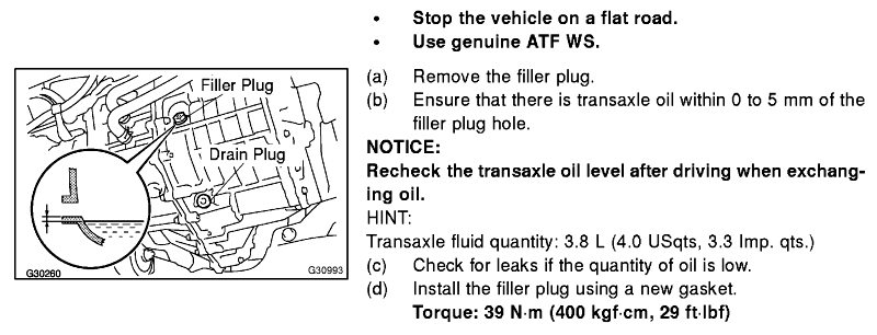

    Transmission is highly recommended on this site. Its a dump & fill but dealers always call it a flush. Its not a flush,
    As far as trans fluid is concerned its a manual gearbox. Takes 4 quarts of Toyota WS Fluid at about $9 a quart. Shouldn't be more than $125 at the dealer.

    conventional wisdom is 30,000 miles then every 60,000 miles for the WS ATF in the transaxle, mine was $110 at the dealer.

    The dealership's use of the word "service" is vague. The US schedule has no fluid change interval; there are periodic "inspections". My 2 cents, regular transmission (Toyota usually calls it "transaxle") fluid changes are cheap insurance, never mind what Toyota says. Maybe after the first year, then bi-yearly thereafter. Might be overkill, but it's a cheap and easy job.
