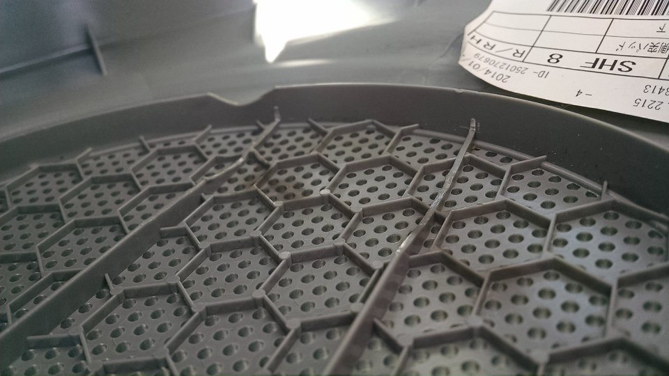

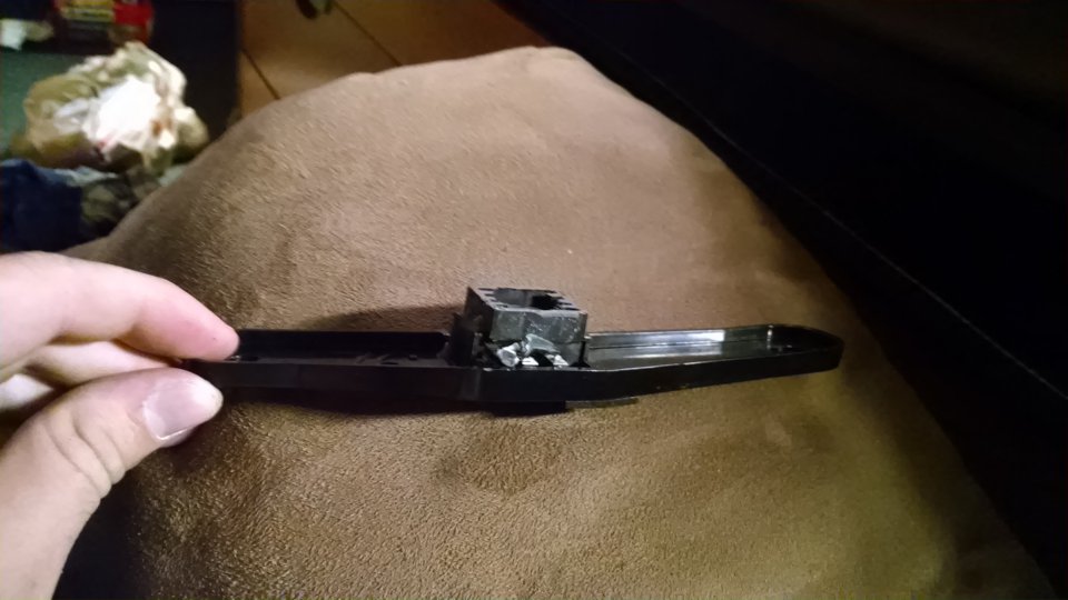

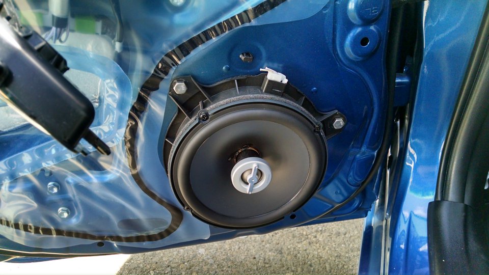

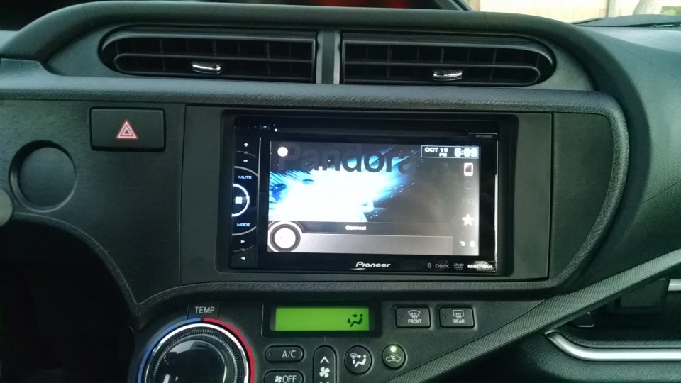

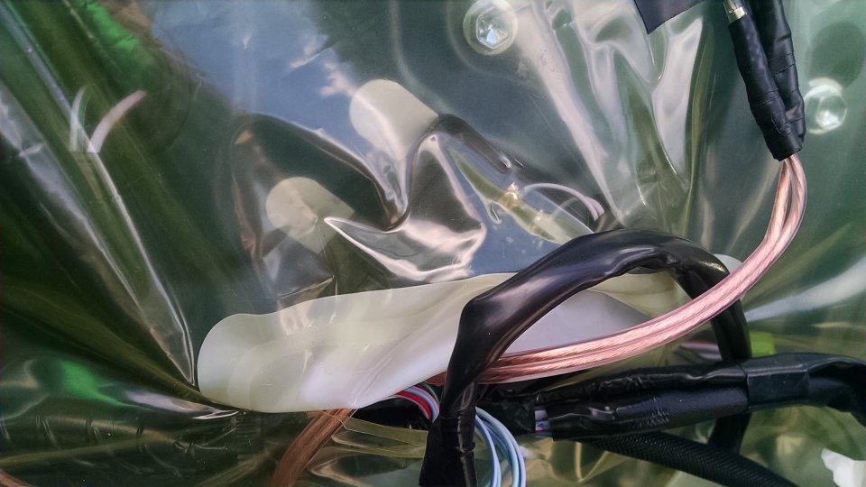

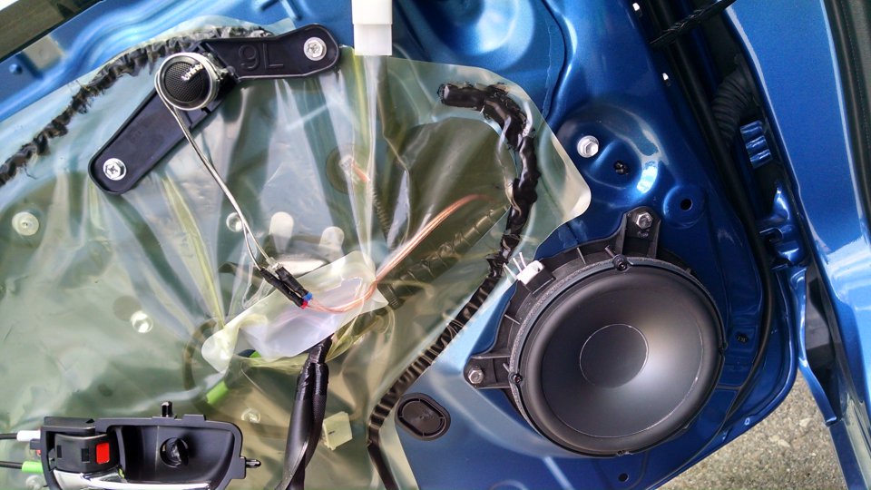

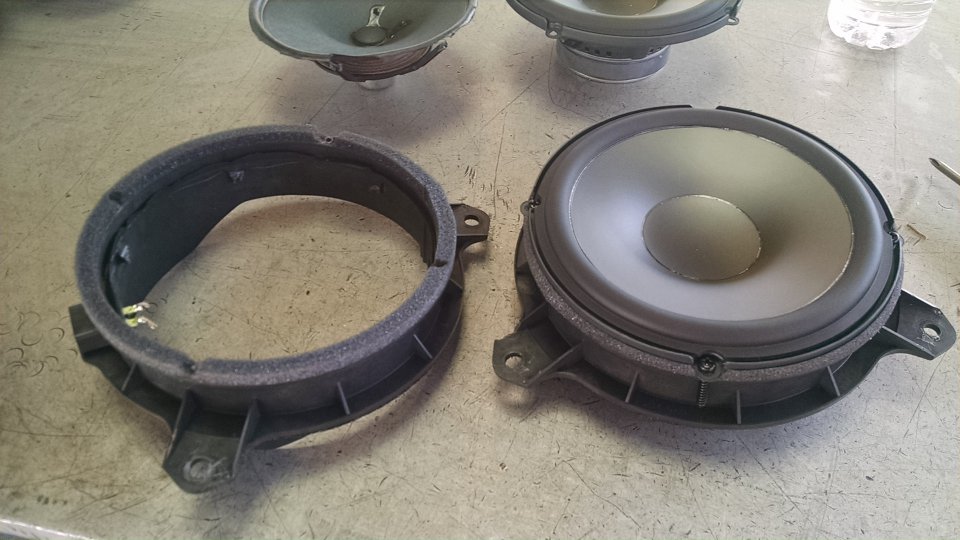

    To install the speakers in the rear what I did is unscrewed and popped off the door panels, took a drill and removed the rivets holding in the speakers.
    Once the speakers were out I took a pair of dikes (wire snipers) and cut all of the plastic arms as close as possible to the plastic wall on the back side of the speakers and clipped the two wires inside the speaker than took a razor blade and cut the paper cone out as close as I could to the plastic housing. Now simply screw the new speaker into the old plastic housing, attach factory wires through the door and screw it to the door with large stainless screws. IMG_20140927_154728603.jpg IMG_20140927_190408127.jpg IMG_20140927_191914626.jpg IMG_20140928_120417276_HDR.jpg IMG_20140928_123314115_HDR.jpg IMG_20141019_130035751.jpg IMG_20141018_180510292_HDR.jpg IMG_20141019_180906328.jpg IMG_20141019_180842691.jpg

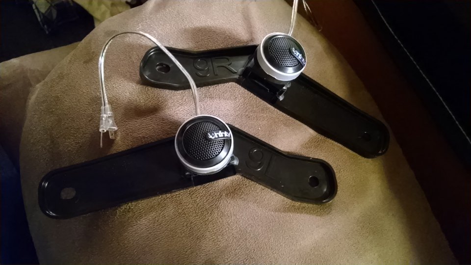

    For the front you do the same as rear except for the tweaters. For the tweaters unscrew the tweaters and mount. Take a hack saw and cut off the factory tweaters right behind where in goes from the tweaters to the smaller square shaft. Now appoxy the new tweaters to the mount. For the crossover block I used command poster strips and mounted it to the door. Wire it all up and put the door skin back on.

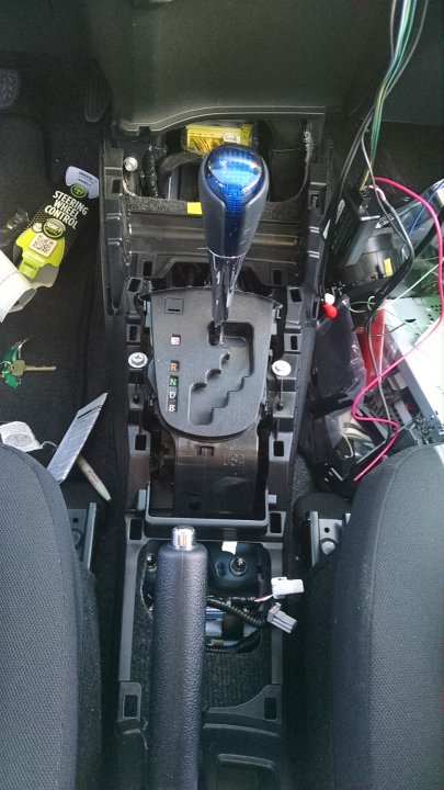

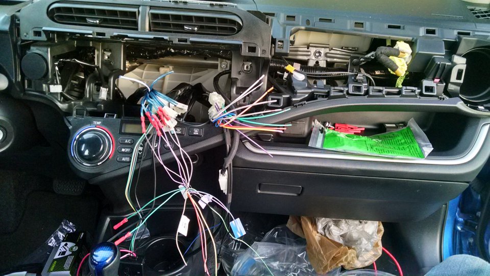

    The amp and head unit was very simple. Pop off all of the plastics on the dash unscrew the factory head unit unplug it. Take all of the adapters and plug them in. Take 8 5.5foot lengths of speaker wire and one length of wire for the amp turn on (make sure to label each wire from radio to amp and from amp to speakers and what speaker like right front etc...) Take a roll of electrical tape and tape the wires up into a nice neat roll, run it down the dash under the center console and out under the passenger seat wire up the amp, plug it all in put the dash back together and you are set.

    The amp fits perfectly under the passenger seat you can't see it from the side front or back unless you have the seat all the way forward, and at that point you can only see the edge. I didn't screw it down because there is a little valley it fits right in no movement.
    I am going to do eastwood Thermo-Coustic deadening next month when I move back to oregon, even without sound deadening and the amp gain at less than half way it sounds amazing!!

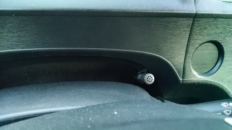

    If you get all the parts I listed everything works except the factory mic however I ran the one that comes with the new head unit in the dash and out on top steering wheel

    The head unit turns right on just like stock, the only difference is it takes a few seconds longer for the Bluetooth from my phone to hook up
