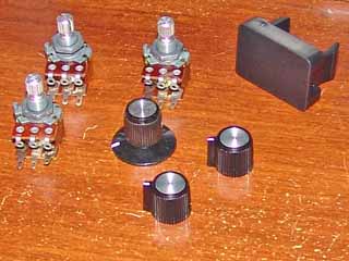

    So here is what I'm selling. I have 4 POTs, 2 different styles of knob (4 total) and only 2 knockouts for the dash.
    Each knob has set screws to attach to the POT shaft. One knob has a skirt the other is just a straight knob with a pointer.
    You can select what knob combination you want. First come first serve.

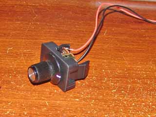

    Each will come with the 520ohm resistor soldered on and two wire pig tails. The dash knockout kit will come complete with knob installed on the knockout like the picture below.

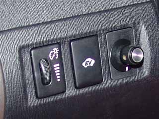

    Here is the knob installed in the dash. Its is the perfect location for this hack.
    [IMG]
    Here is the dash kit.
    [IMG]
    Here is what the knobs and POTs look like.
    [IMG]

    Any suggestions on pot location for a 2005 -- with one less dash knockout hole and EV switch occupying one -- to provide a clean-looking and practical install like yours?

    Thats a good question. If you ever find a good location let me know. I'm still using all three spots in my car. I'm still using my bread board on my dash for my coolant temp hack. I'm thinking of putting it below my 2nd LCD screen. It will still be in easy reach but it would be at an awkward position. I also thought about putting it on the dash but my 2006 Prius has a foam padding and the shaft of the POT wont fit all the way through it. So I'm still looking.
