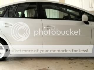

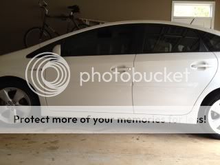

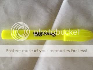

    Here it is.....Instead of a grease pencil, I used one of the new gel type yellow sharpies to mark my lines. Wipes right off when you're through. Took me about 20 minutes. Folded my mirrors in and then measured down from the body crease right where the the edge of the folded mirror meets it 8 and a quarter inches. Then measured down ten inches from the body crease one inch in from the rear edge of the front door. Connected the two marks using a level. Then ran the level across the vertical door line to the back door and contunued to draw the line for the rear piece. I think the moulding follows the natural waistline of the car. Figured the measurements just by sticking the moulding in place with painters tape and eyeballing, moving, eyeballing, moving until I felt the placment was visually correct.
    Very happy with the results.

    Looks good (though the pics are really small). Clever use of the pen!

    Nice work. I usually don't like side molding but the white color hides it well. :)
