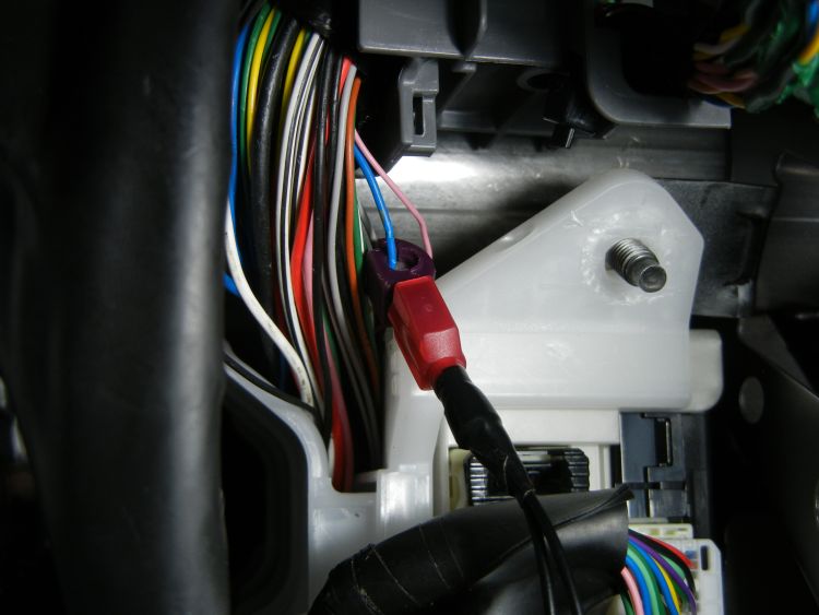

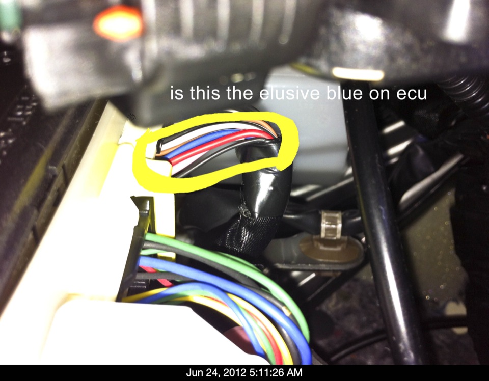

    here is a pic of a member's tap of elusive blue.. and i see the pink wire there so i think i'm on right track..

    To be 100% sure, you should go pay the $15 to access the Toyota Techinfo site and look at the schematics/pinout. Here is the link: https://techinfo.toyota.com.

    Your on the right track but be careful. In my picture there is another blue wire across from it on the connector. That is why you need to look for pin 52 on the correct side.
    Here is a better picture when I removed the connector to look at the pin 52.
    I included the schematic of the connector for reference.
    Ignore my earlier comment in the old pic.
    Looks like you were up to the challenge. Great job.

    chickenhawk, as you can see from rrg's photo, there are many blue wires from/to that ECU... the best way to determine if you got the right one is to get a multi-meter and test the wire, or use rrg method.
    GPG- you have a model III and that more than likely means there are even more wires going to that ECU and unless you find 52 you will likely need to test the wire too as I mentioned above.

    i see there is a yellow clip on the connector.. do i have to take that off before taking connector off ? I will try to attempt it this week. also i notice the signal light is bearly noticeable during daytime. i wished they used brighter led or more led in the setup for the signal. once sun starts setting the car looks bitchin.. (y)

    Yep, yellow clip comes off first. BTW, the pics look fantastic!
