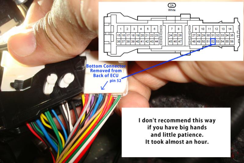

    Would it be possible for you to identify which area of the car this is at? I tried to look but can't seem to find a match for your diagrams.
  12. sfv41901
    sfv41901 Masta S
    May 5, 2010
    4,591
    5,291
    Palmdale, Ca
    That blue wire is going to be on the rear plug of the BCM (Body Control Module) that is to the left of the steering wheel on a LHD Prii.
    The BCM has a total of 5, sometimes 6 connectors.....2 in the rear & either 3 or 4 in the front plus the main white power wire from the fuse box.
    s2kinfinite likes this.
