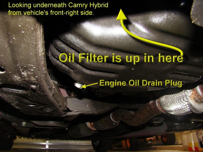

    I don't want to lift the car at all. Where is the oil filter located?

    It is pretty difficult to take a photo of the filter itself without raising the car but, here is a photo that shows where it can be found relative to the oil drain plug which is a lot easier to find.
    [IMG]
    BTW, I had no problem at all removing my factory oil filter with my oil filter removal tool very much like the unit in the photo one or two messages prior to this one. I have not needed to raise, ramp or lift the vehicle at all to do my oil changes.
