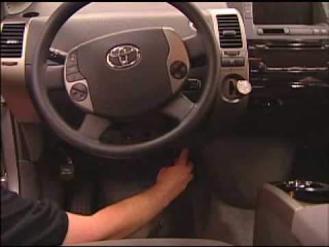

    Check your owners Manual, there's a button under the dash in front of the driver, if the sensors are present it should reset.

    Ah good info...
    I googled it.

    If you have new sensors, they have to be reprogrammed. If they remounted the old sensors, then the reset may work.

    Well, like I said earlier, this worked for hundreds of miles before the light came on so I suspect it just needs air. Correct me if I'm wrong but if it needs to be reprogrammed or there are no sensors at all, that light would have lit up immediately after the wheels were installed, right?
  9. dc202
    dc202 Member
    Apr 14, 2009
    230
    Pacific Northwest
    Might take several miles, but should not take hundreds as far as I know.
