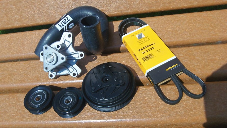

    Hey Strasma, I dunno, I think I'd put a timing belt in it at 90k anyways, just to be on the safe side. LOL!
    If you search 2002 Prius alternator on Ebay you will see 7 of these phantom parts listed for sale too!
    Today I swapped the serpentine flat belt on my 02, and everything related to it at 160k.-tensioner pulley, ac clutch, water pump. Bought all parts on Ebay for $100. from separate vendors, and all arrived in 3 days!
    With only 90k on your Gen 1 you are looking forward to a lot of economical miles. Robert 149_6184.JPG 149_6184.JPG

    Why did you replace all of those parts? Was it just at that mileage or did some need replacing? I read earlier that most do not replace these parts until the water pump until it starts leaking, pulley starts making noise, belt has aged and has gotten cracked and so on. Just curious as I usually replace certain parts when they fail and others from age.

    Hi Kutcht, fair enough question...the car is at 160k miles, if I do it at home it's cheap But if even 1 of the belt-related parts goes on the road when I do my fall migration from Maine to Texas, it's a tow, hotel, and repair bill. So I changed everything serpentine-related all at once and saved the old belt for a spare in the trunk, now I expect new-car reliability from that area of the car.
    I had the serpentine tensioner pulley go bad on the road in the past on a Dodge pickup and on a Mercedes 300 SDL...on the Benz I was doing 65 on the highway, heard the bang, and actually watched the pulley rolling straight down the road ahead of my car!
    Wish I had a crystal ball to look ahead on repairs.
    I took less than 90 minutes on the lift to change these parts, shim the ac clutch, and change oil, hardest was the water pump which is a little tight to get at.
    Car runs quieter now, as both the tensioner pulley and the clutch bearing were a little noisy.
    I liked the prices on Ebay parts...$22.00 for a water pump, $8.00 for the belt.

    G2 is the same as Classic except that the air conditioner compressor is electric, not belt-driven. Hence the serpentine drive belt needs to be periodically replaced while the engine coolant pump and idler pulley need to be examined from time to time.
