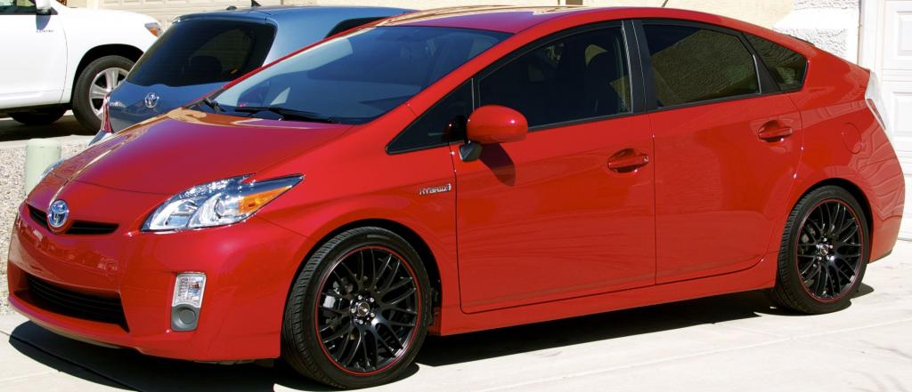

    Randydid's Prius dropped on Eibach ProKit.

    I'm on Eibachs. The ride is similar to just about any lowered car that I've owned. Smooth roads are great and the ride isn't bouncy.
    If you were to get lowering springs, I would also recommend you get a rear swaybar installed too.

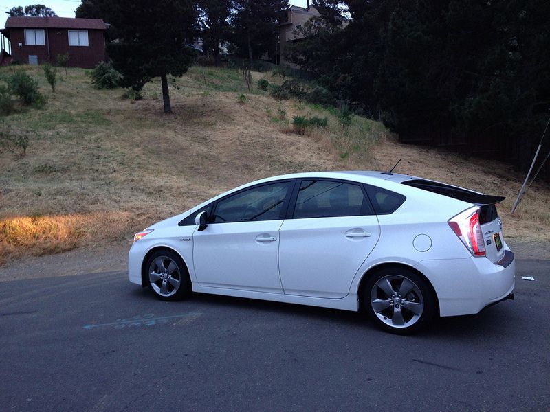

    Bullet Salvador likes this.

    Ok, that looks great. I thought the eibachs were a little lower in the front that the TRD?

    I thought that thread had it in there? I guess you're still after Eibach's huh?
