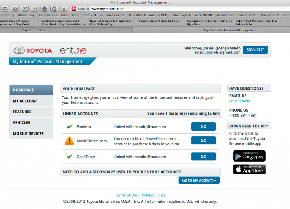

    have you logged into entune with your pc and "linked" the apps?

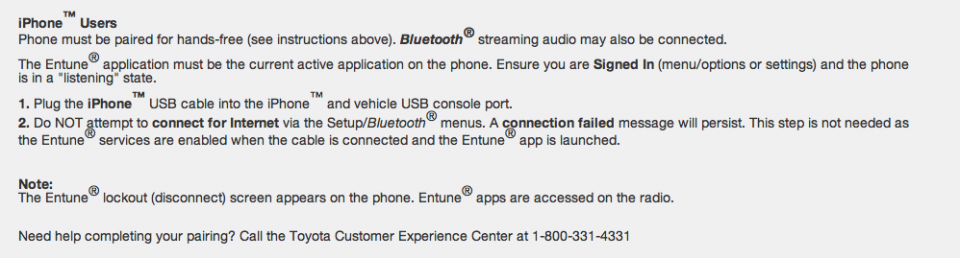

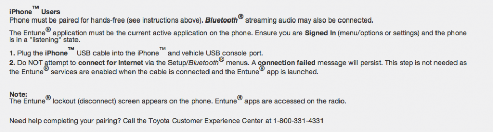

    I think I found an answer: The iPhone should NOT be linked via the BLUETOOTH Setup Process. [SEE ATTACHED NOTE]
    I'm going to try it. I'll report back if successful.

    The problem is you do not have tethering. Using the Connect For Internet option in the entune settings is for tethering from your phone over bluetooth. To enable it click the gear next to it and check the box for enabling dun/pan connection. Then back out and connect. Make sure tethering is enabled for your phone. Yay, you will now have internet. After doing that it will automatically connect to internet over bluetooth tethering whenever you try to use an internet app.
    Except if you don't have tethering then that will not work. The only way to connect to the internet without tethering is to plug your iphone in over USB, and then open the Entune app on iphone. After a few seconds it will switch to a screen showing it is connected to the car. The car will throw up a popup asking if you want to connect to the internet through your phone. Click yes to that and you now have internet.
    Those are the only two options for internet, and they have always both worked properly for me on my iPhone. The problem that everyone has is they either don't have tethering on their phone, they don't enable the dun/pan connection, or they don't understand they need to be plugged into usb AND have the app open if not using bluetooth tethering.
