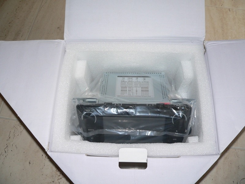

    An update. I can report that this seller seems pretty good. He shipped the unit DHL and it arrived this afternoon. It was well packaged, with an outer box tightly fitted around the inner box and the unit itself well packed in foam:

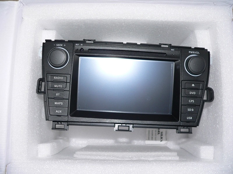

    I can confirm that it is definitely a RHD unit and that it comes with the special aerial adapter needed for European models (the EU Prius comes with a rectangular plastic aerial connector). Overall the finish looks OK, the texture is slightly coarser than the original head unit, but the colour looks pretty close. The quality of finish looks good, better than the last Chinese head unit I bought. I can confirm that it is made by Shenzen Soling Industrial Co, in fact that's who this ebay seller seems to be according to the shipping paperwork. Here's a front view:

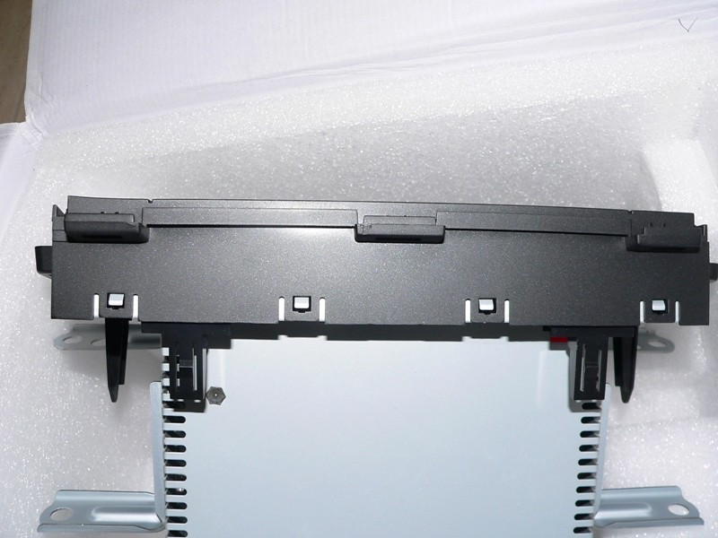

    Just to confirm that this is a right hand drive only unit, here is a view of the underside that shows the asymmetry in the shape of the front panel:

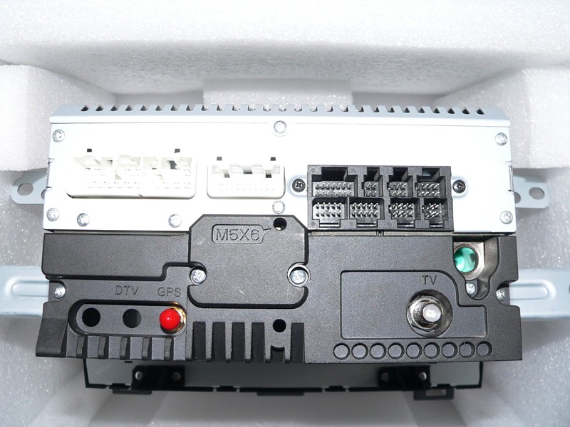

    Here's a rear view, with a plethora of connectors. It looks to be plug and play as far as I can see, all the connectors seem to match those on the car, so no adapters will be needed. it even has the power feed for the built in antenna amp already wired up.

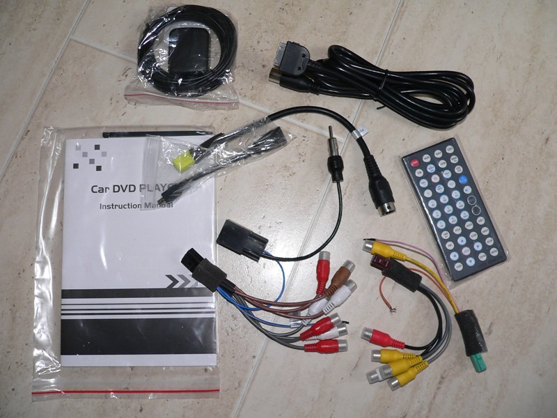

    Finally, a photo of all the connectors etc.

    any idea whether it will work to control the HUD for nav prompts? seems a long shot but i'd really like that feature...
    I also like the TV connector. kind of redundant now since there's not many analogue broadcast areas left!

    AFAIK none of the after market units will drive the HUD, plus the non-nav cars don't have the nav symbols in the HUD to drive, I believe. I'm not sure how the HUD is driven, but would guess that it needs a CANBUS connection.
    It may be possible to fit a DTV adapter to this unit, although I don't have any details, as there is DTV connector space on the rear panel. It does come with a TV antenna that looks like it's intended to fit inside a window. I won't be fitting it, as I don't really need TV in the car.

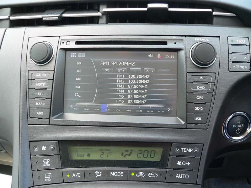

    I managed to get it fitted this afternoon, but still need to sort out the nav software.
    [IMG]
    Overall it is a much better match to the dash than I thought it might have been, it pretty much looks like an OEM bit of kit. Fitting was very easy, just plug and play. It even has the right wiring to power up the JBL amp, so all the speakers worked with no need for any mods or widgets. Biggest job was fitting the GPS antenna up near the windscreen base, something I hadn't bothered to do with the last two installs but thought I would with this one (up till now I've just run units with the antenna stuck on the top of the unit, inside the dash). Basic fitting time, bearing in mind that I know how to take the dash apart, was probably ten minutes, plus another 15 minutes spent fitting the GPS antenna.
    Menus etc seem self-explanatory and it's got a much better user interface than either my Kenwood or the other Chinese HU I tried. The radio seems to work OK, probably about the same as the Kenwood and slightly better than the stock unit. As far as I can tell AF works OK, it retuned OK on a brief drive around the block. Station data display seems a bit hit and miss, sometimes it shows the station name, sometimes it doesn't, but that's not really a problem.
    Overall I think this unit offers exceptional value for those of us in the UK. For just under £281 I have a unit that seems to compare well with units costing more than double, and it looks as if it was made to fit the car.
    Based on my limited testing I'd recommend it, with the proviso that there is bound to be some work needed to get the nav side working as I'd like it.

    What does the map card button do vs the SD card button? Just to switch between cards?

    They're not really buttons, just little covers over the micro SD card slots, the aux in connector and the front micro USB connector. They lift up to reveal the slots and connectors underneath, and just click into place to keep things looking neat and tidy
    Switching between radio, nav, DVD etc is either from the steering wheel controls or the buttons down the side, or you can pull up the whole system menu on the touch screen and select pretty much anything you want, including reading ebooks............. (not recommended whilst driving!). The thing is like all these units, it runs WinCE 6.0, so pretty much any WinCE app will run on it.
