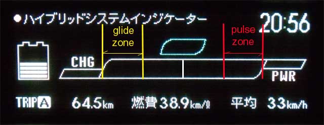

    In Japan, we have been discussing how to pulse&glide on the 3G Prius.
    Our conclusion is we don't have to be so sensitive for the zero amp (no energy flow) gliding and a weak battery use is acceptable, therefore 0-25% zone on the HSI screen is acceptable.
    Also, a slow acceleration is not good for the ICE efficiency, therefore 75-100% zone is recommended for pulsing.
    Ken@Japan
    [IMG]

    nice info
    so on the gen 3 a slow acc. is not good for eff.
    but is that not the oposite of the gen2?
    maybe because of the bigger ice?
    o and amazing picture.
    thats 2,57L/100km and or 91,5 mpg.

    I believe we've been discussed a briskly acceleration is also recommended on the 2G Prius.
