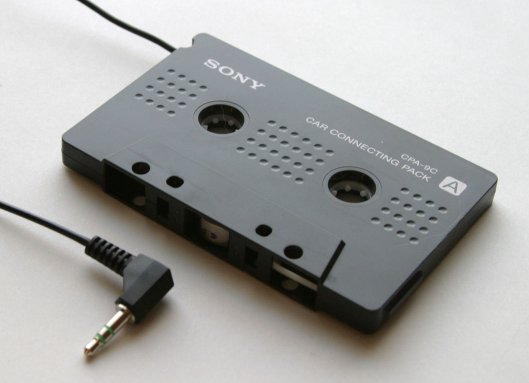

    I'd like to suggest an alternative on the CD drive: cassette adapter:
    [IMG]
    I use one with my iPad but the same adapter also works with any headphone output device. The beauty is you can carry the player into a restaurant or work and get a lot more utility than if it sits in the car all the time.
    usnavystgc and WHCSC like this.

    I also use a cassete adaptor for my Mp3 player and it worked fine untill last week when it ran the battery on my
    Mp3 down , untill I find out why I'm a little leary to use it.
