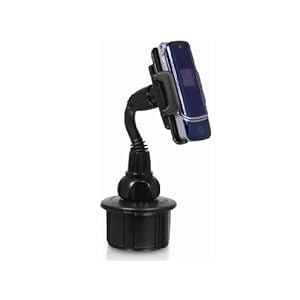

    Just did some googling and came up with this:
    [IMG]
    Black Macally MCUP Universal Cup Holder Phone Car Mount For Cell Phones | eBay
    It looks like it might fit one of the front cup holders in the C. The goose neck would allow quite a bit of adjustment.
    Looks like it will work, but I don't have a smart phone. If I ever do get a smart phone, I'd probably give this a try. For under $20 you can't really lose.
